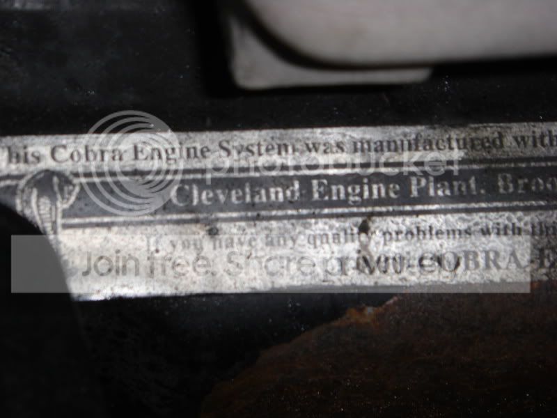

Well, the manifold is a cobra, and there's a label on the drivers side valve cover that tells where the Cobra engine was built... I'll take a look and see if what was stated, meets what my engine has... I really hope it's a Cobra engine... I'm guessing my fuel pump is just a stock GT pump....

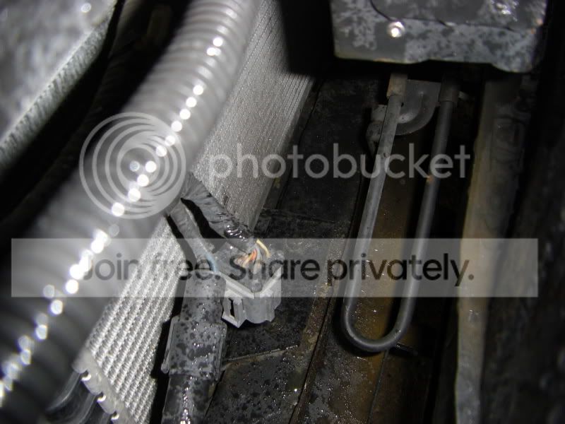

Also, when I looked, it seems this car had been hit in the front from what I can tell.. The bumper was great, the hood latch doesn't work good at all, and i can see a dent in a crossmember.. Oh, and the core support is new. So, I'll check for an oil cooler.. Is there any way it coulda been bypassed from an accident?

I have no idea where the engine came from. The guy I bought it from said he bought this car, threw a rod in that motor, so he bought this engine from a friend, and had a shop install it, told me it was a direct swap.
So, here are the pics...
Injectors.. Blue= good?
Valve covers, drivers side had this label on it.
This is in front of the radiator, it's empty.. The radiator is new, and most everything up front looks like it was replaced, which tells me it was in an accident... Is it possible that they bypassed the oil cooler being the car is a GT? Should I get an oil cooler for it?
