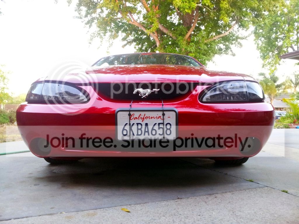

I don't think I've seen anyone with one. Any ideas to temp hold the front plate for cobra bumper?? I will not drill into my bumper, but I'd like to have one on and just be able to remove it for shoots or something...
I'm thinking just some zip ties, but if possibly some tape I guess?...
Temp Fix!!
I wouldn't use the bracket, it leaves an outline mark on the bumper over time. And to be honest that looks like trash.

Hopefully you don't have to parallel park with that plate holder in place. Even the magnetic ones that attach from underneath...All it takes is some tool to back into your bumper when parallel parking and a mark will be made on the bumper.

And those zip ties are probably going to scratch the paint too...up under the pony there and maybe the lip just before the bracket.

I would grab some strips of steel or better yet aluminum and bend up a bracket to mount it under the radiator support. bend it to go up through one of the air holes in the bumper and have it about 1-2 inches from the paint, cover the entire bracket with plastidip or something and maybe put some rubber or foam behind the plate in case anyone backs their car into yours and pushes the thing into your fresh paint.

you dont care if those zip ties scratch your clear? if they havent already they will once you hit some bumps or even the wind shifting the bracket will def scratch it.
