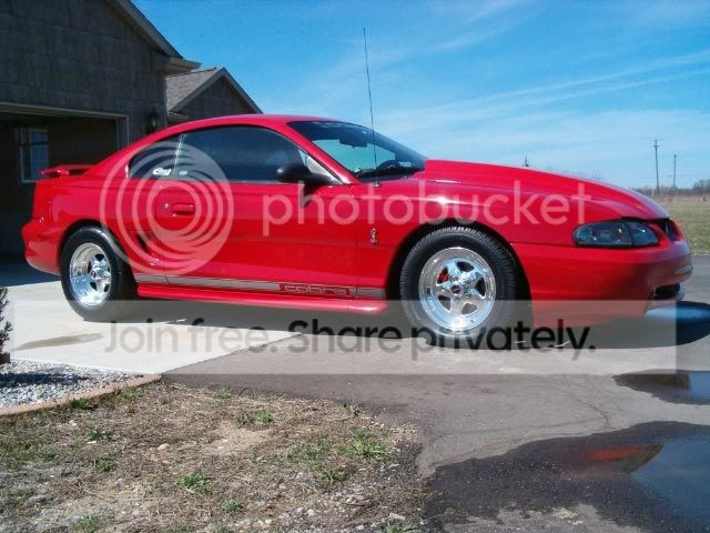

ABC exclusive cobra rr hood here. Fit was great, quality great, heavy metal hood latch
Been running 2 years now. I just recently put hood pins on. 1 less worry :thumb:

That's a bad ass looking cobra!
