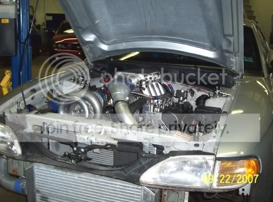

I'm considering a victor junior intake with a 90 mm tb from a 5.0. overkill, but I'm trying to do something that looks mean under the hood. still working out details as money comes in.
90mm is going to be more than just over kill, its going to devastate your set up. unless your running forced induction 78mm is still pretty large. If you're wanting to drop the money on a bad ass intake set up that isnt "too" expensive IMO (for what it is) that makes great power and looks gorgeous you should check out the Logan Motorsports 2v intake. When i get the money thats definitely on my list of things-to-do.
its just down right nazzzzztyyyyyyyyy!
