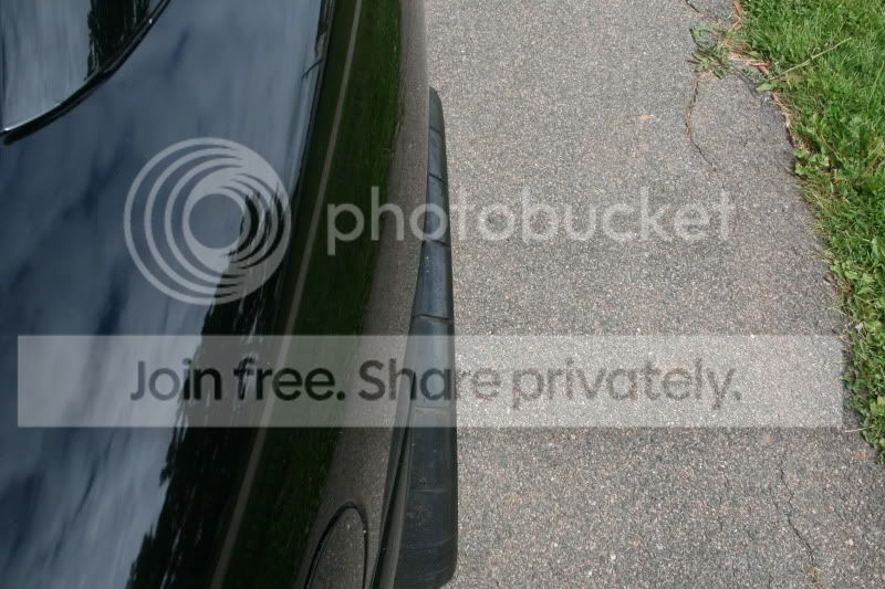

Side by side comparison of the front BF Goodrich 275/40/17s v.s. BF Goodrich G-Force TA 275/35/18
Side by side comparison of the rear Kumho V700 315/35/17s v.s. Toyo Proxy TQ 315/35/18
Still have the 1/2" spacers on and I need to pull them off and install the low profile Maximum Motorsprots IRS bolts.
