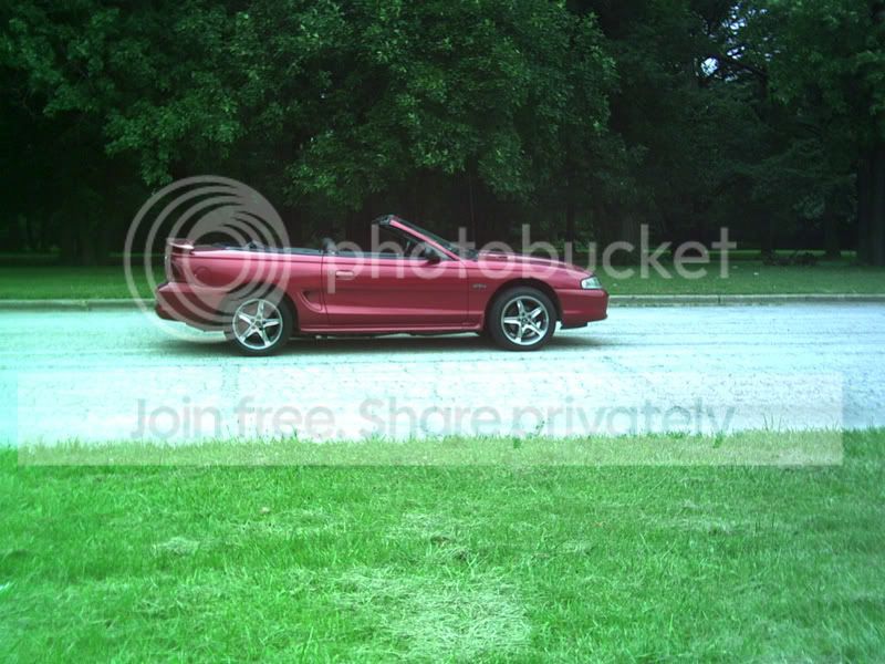

My exhaust has been hanging low and scraping everything out there. Sometimes i would back into my garage and get stopped suddenly with a loud thomp as my exhaust got caught on the raised part of the ground. Its been like this for over 8 months :rollinglaugh: The reason for all this is because my hangers are broke where you connect the o2 sensor by the crossover H/X part, so it just sags like a mofo. I just thought to myself since my exhaust is dumped i have un-used hangers at the back by the gas tank where the tailpipes use to be. So, i took off those big hangers and placed by at the middle of the car where the broken ones was. Now it doesnt scrap anything :behind:
Im surpised i havent knocked off my whole exhaust by all the bumps i hit and i heard my whole exhaust system shift and make the nastiest noise ever.
And for the people who dont know how my exhaust use to look.. dont get sick :puke:
Yes, you can see my mufflers sagging with my hpipe... just look close :ass3:
Now with everything fixed.. its sucked up under the car like it shouldve been. :behind: :behind: :behind:
