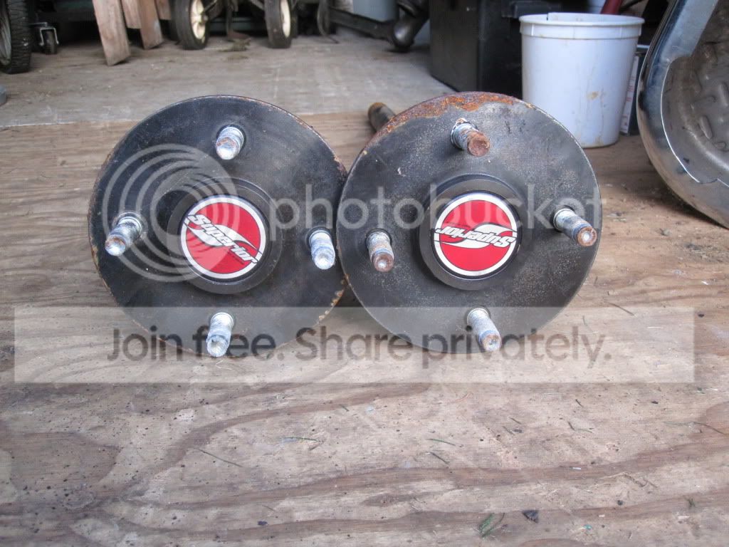

When you say that the housing needs to be 31 spline too, what do you mean by that. I figured that the t-lock unit inside needed to be upgraded to 31 spline and the outer bearings needed to be changed for the fatter axles. Is there more to it than that? And unfortunately, it looks like the upgraded axles are 4 lug, from the picture. It would actually be easier for me if the axles were not 31 spline. Did ford ever make an 8.8 rear with 31 spline axles stock for the mustang that I could get axles from? Aside from cobra stuff that is rare. I dont want to have to spend $200+ for new axles. I was hoping to keep this low budget.

I meant the t-lok, sorry. Cobra 8.8 is no different than GT, except brake hardware.
If the Fox axles were upgraded, they *typically* have some sort of stamp/label on the ends indicating that.
example ...
Explorer 8.8 were 31 spline from factory. However, I'm not sure the axle lengths will work with a Mustang. Maybe someone knows ...
