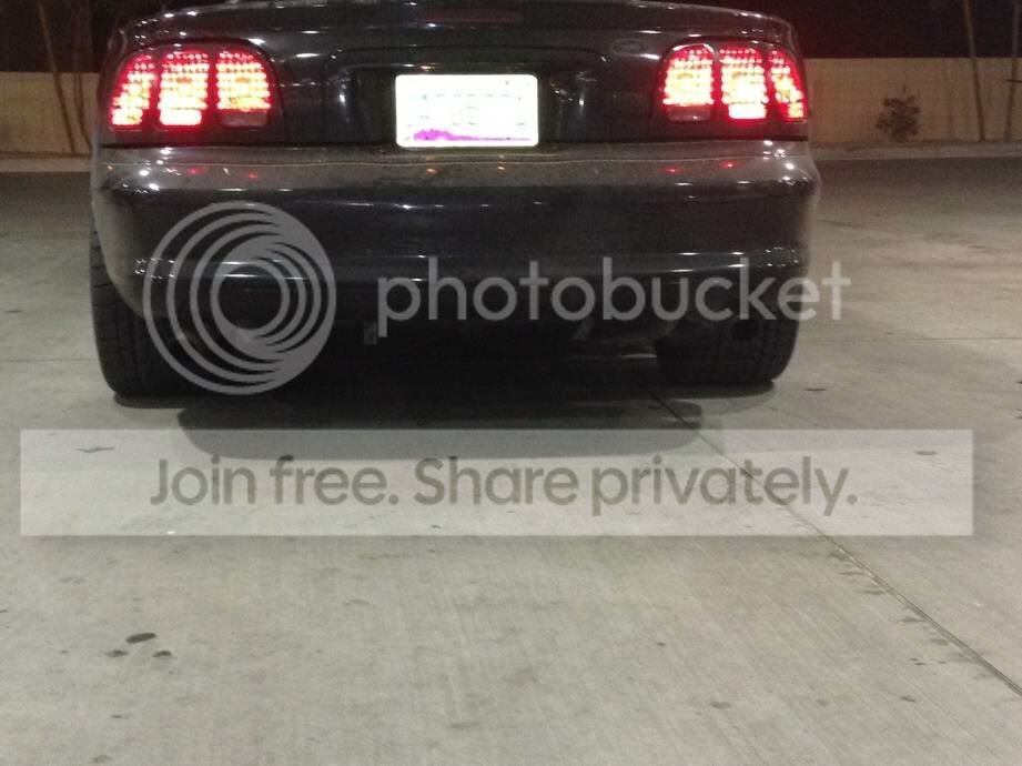

Far as 315 on back its all about off set I have them out back an don't rub a bit an I have auto I have a 315 35 17 an I'm drop 2 an a half in n the rear when a 11 in wide wheel but you do need to roll them but they don't stick out one but the main tying is take in the quad shock off an beat in the Hell out of the inner finder
