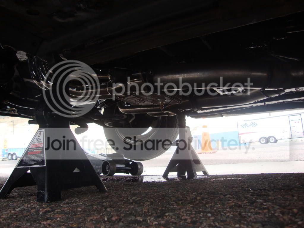

I was testing the car for the new "True Street" that is going on at my track... 15 mile cruise and 3 back to back passes without opening the hood... So I was hot lapping the car... Playing with timing a bit and hot lapping the car... I made 4 passes in about an hour(the last hour). this was my last pass. Really makes me realize how lucky I was. Had any of the fluid gotten on one of my tires I would have been testing out my cage. Turns out the NHRA approved rubber line i used for transmission lines, burst around the 330' mark... I didnt realize it til about the 1000 foot mark where I let out of it and shut it down. Could have been really really bad...
Bursting Transmission
see the puddle? I left that all the way down the track too...

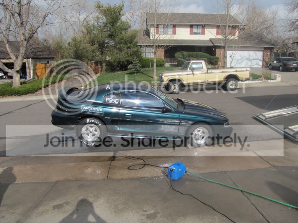

Had to power wash the car off after wards... This is how I did it LOL.

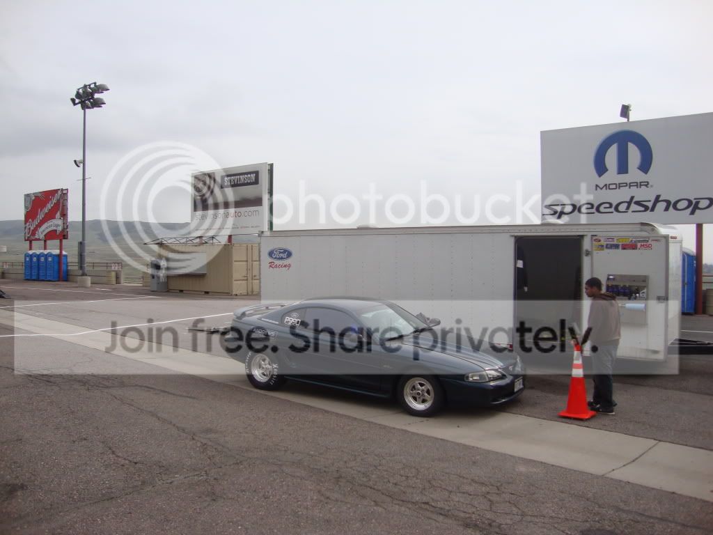

Yep still got the trailer... its the ones in the pictures, and i took it since I needed tools yesterday incase and since i was tuning it a bit.
Bandimere does a great job cleaning the track, but it still always sucks being the first few cars down the track after an oil down...

Can I make a suggestion on your trans temp sensor? plug that hole on the bottom and tap it in the side, If you ever do a big wheel stand and slam down you gonna have a big mess again.

Agreed... I have wanted to do that for a long time, but never wanted to drain the fluid out and do it... now that is has none in it, ill be pulling off the pan and tapping the side of it.
