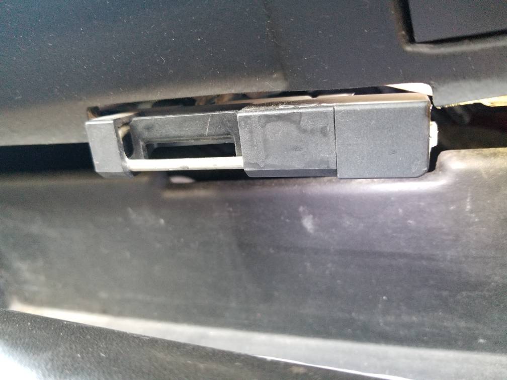

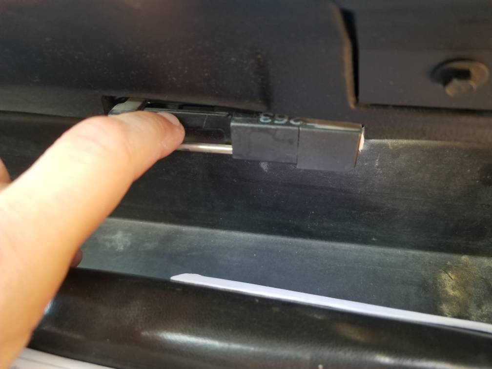

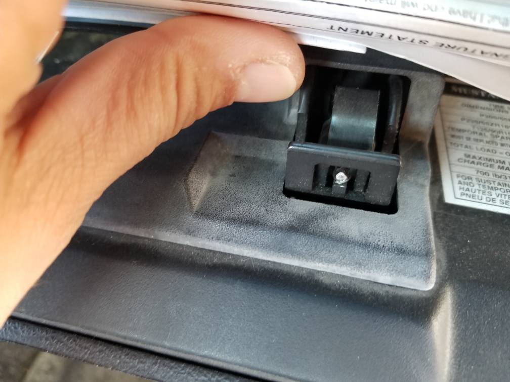

So the third pic my finger is touching the on/off switch, there is a lever built into the latch that activates it. First pic is the release lever on the door, the bulb goes in onthe right side

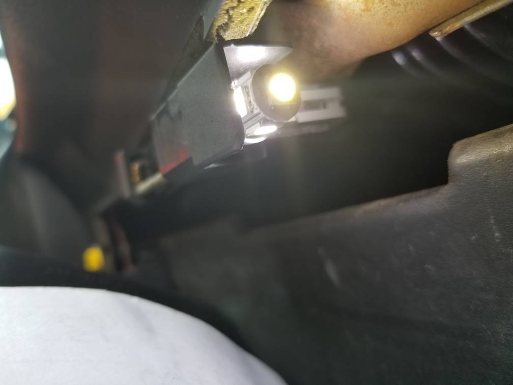

Here is a reference for light bulbs I have used in the past:
Said to be a 194 bulb from the above reference.
I see in my Amazon purchase history I bought some so I assume this is what I used:
