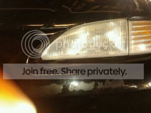

I got tired of not being able to see when driving at night in the GT so i decided it was time to try some headlight restoring products. I didnt want to buy new headlights right now.
I went to Theisens (farm store) and picked up some Blue Magic headlight restoration stuff and got home and tried it. I was VERY skeptical of it. I started it and first pass cleared it a little and the second pass really cleared it up. I wasnt expecting crystal clear but this stuff made a HELL of a difference.
Heres what I got:

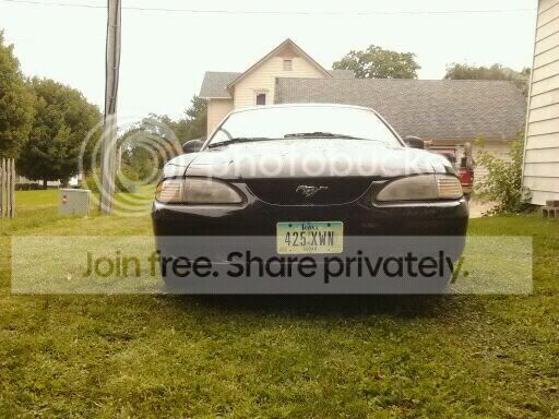

i didnt take any befor pics but I have some pics i think that you may be able to see the hazing in em and I will go shoot some afters :)

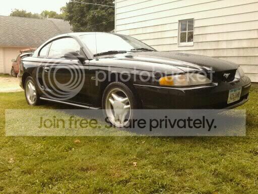

Heres some pics you can kinda/sorta see the hazing:
I will go out right now and shoot some after pics :)

Heres the finished product: (not perfect like new but a lhuge improvement over the befores)
Dont mind the flash :(
