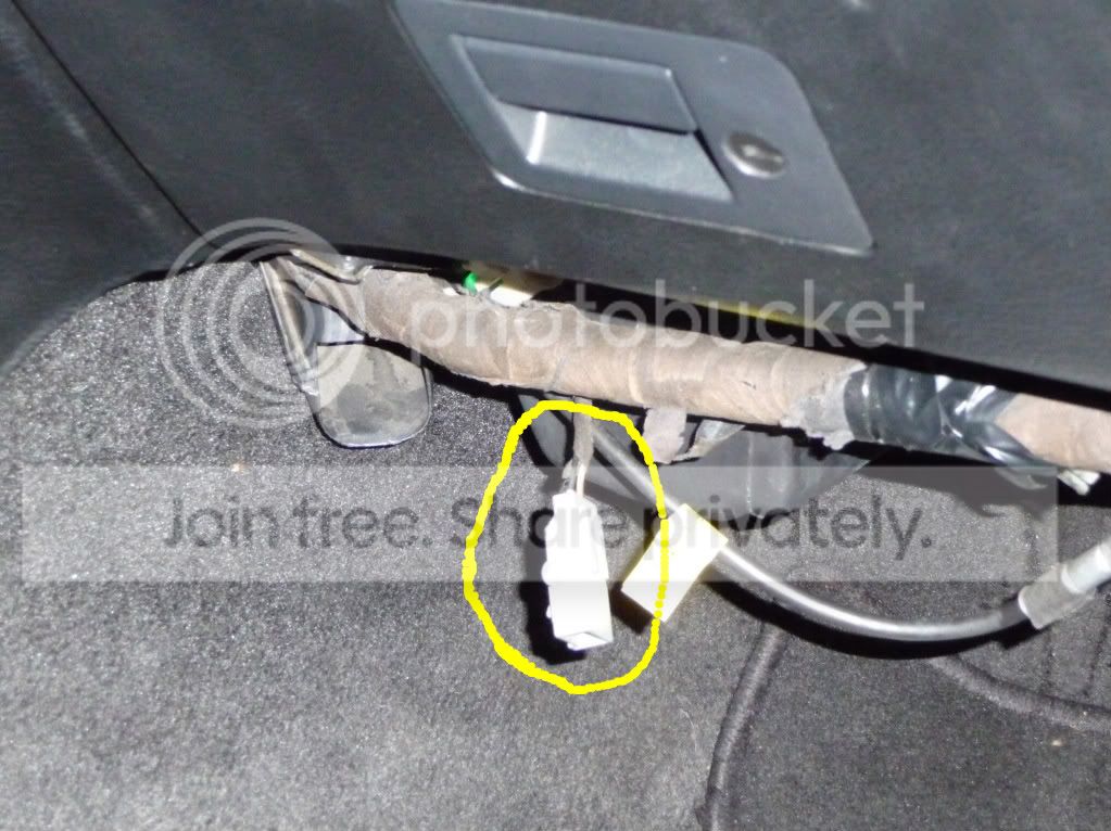

3rd heating core. it went so i replaced it, then that one broke at the sautered joint so i replaced it again. I only remember taking off one vacume line under the hood. could another one come loose, or are there any behind the dash that i could have forgotten? There is this plug under the glove box that i dont remember taking apart but i dont see anything that plugs into it. It is a little 2 wire plug. There is also a little plug under the hood i dont remember taking apart. IT is above the lines to the heating core. I dont see the other plug for eather so could it be that maybe?

Also is this suposed to be plugged into something? It is connected to that large string of wires under the glove box.

that plug is to the trunk pop switch which you prolly dont have on your stang. if you have check you vac lines then it may not be that, check spark plugs, wires, coil. My dads taurus was doing some surging crap like that and I replaced the coil and it is fine now. Have you ever changed your fuel filter though, since you had asked that before. How many miles are on the stang?

edit: Just checked the truck release button and it works. Could it be to a light in the glove box? I dont remember if there is a light. or not.

there is a light in the glove box, i'd check the spark plugs/wires/coil to see on the fluttering now. That would be my only other guess. You can see about the plugs first and go from there on that though.
