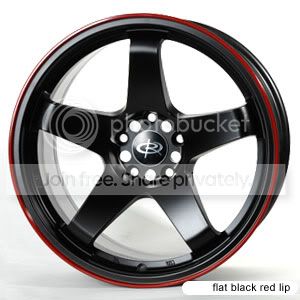

hi guys, im looking to buy these, and i need to find out what will fit. Im looking for a comparable size to 17x9 03 cobra rims. (same back spacing)

Id like to get 17's so i can keep my brand new tires. So is the greater the number in offset the more it will stick out? In other words, 35mm will stick out 10mm more than 25mm? Thanks.

yes. and I would go with the wider on the back.
Maybe these?
Front: 17 x 9 5 x 114.3 +25
Rear: 17 x 9.5 5 x 114.3 +30
How much wider is the 04 axle?
Nice looking wheel BTW. :)
