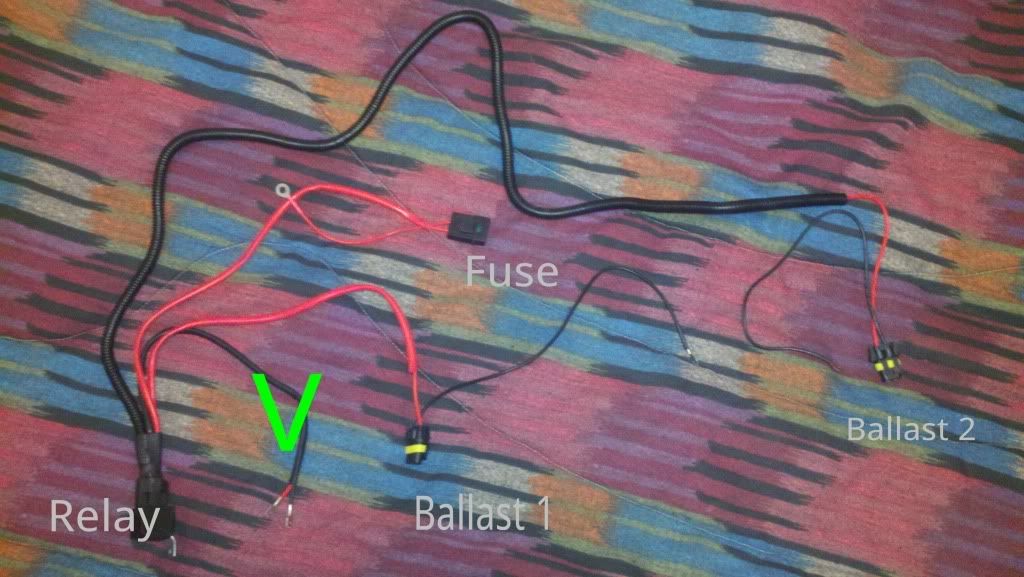

I finally ordered myself some new headlights, HID kits, and HID relays to save the strain on my wires, but I have a few questions about hooking them up properly. I looked at a few online resources, and basically have it figured out, but I'm not sure about the wiring harness.
Below is a picture of the harness I got http://www.amazon.com/gp/product/B00554PNL2
I understand the labeled connectors, but is the one with the V supposed to be the one that goes to the stock wiring harness? It only has separate connectors on it rather than one for the headlight socket its self. is this normal? Do I need to buy a plug for it? This is what confused me.

the parts that you have labeled as ballasts are the part that will plug into your factory hrns's. The are what turns on the relays that supplies power to the ballasts which are the metal boxes between the relays and the lights. Its all plug n play it will be easy.

Yea my ballasts will be here Thursday, I'm just not exactly sure how to wire this all up to use both of the HID kits. I know that each relay powers two ballasts, so that's why i thought those were the right plugs. Do you know what the V one is for then?

Yes, just plug the spaded terminals into your drivers side headlight plug, The ground should go in the middle and the positive on either side....youll have to see which one works with your low beams.
