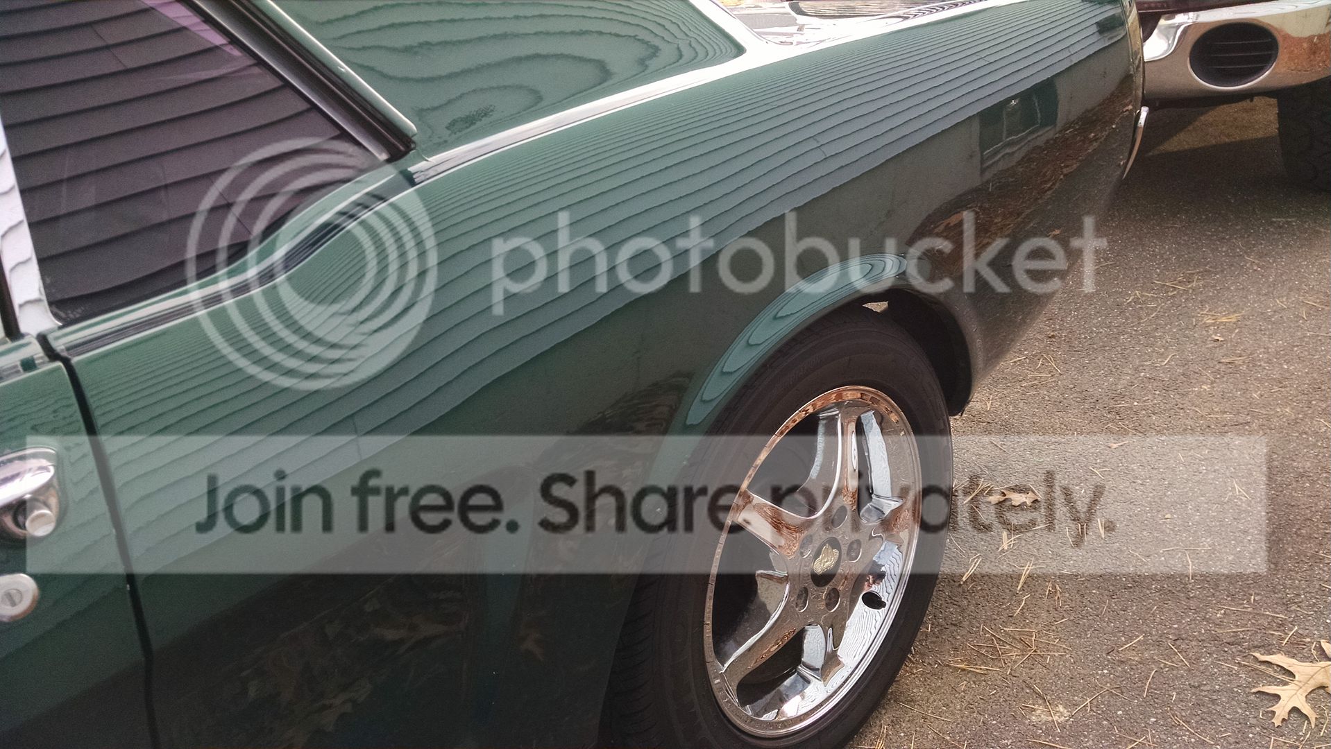

So, as it sits (to my knowledge), it's a 1968 Coupe with I6. Ran well before paint. Basically, the guy I got this off of went through all the trouble of removing all trim, stripping the paint, respraying and clearing it just to decide he had too many projects going on. Judging by the five cool cars he had, pretty believable! My plans for this are really straight forward; convert front to disc (MustangSteve Caliper Mount with 13" 94-04 Cobras), get it running, reassemble interior and trim.

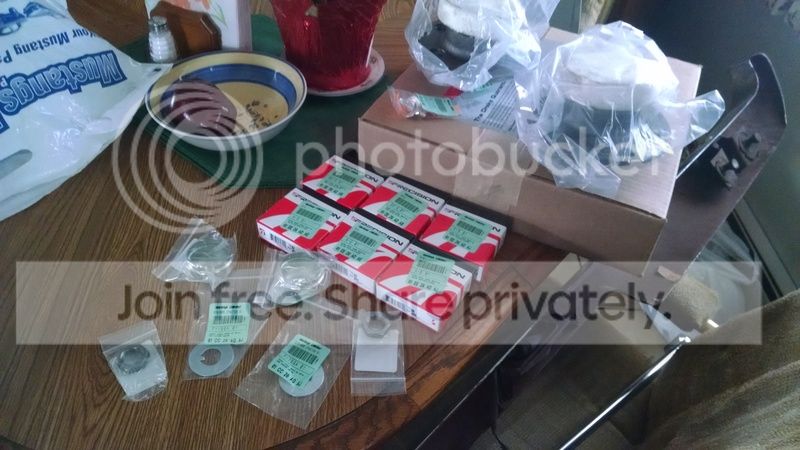

Here's the first part run. I may update with something tomorrow too as I've got to return the wheel studs. I gave the guy the PN for disc studs and got drum studs. Didn't find out until I went to have them pressed.

I'll be finding out soon about those spacers. Cars got 245/45/18s now. Part of me wants to dismount the tires, sell the four lug wheels and buy them in five lug. I'm hoping I can get the '68 running on the cheap. I picked up a lock cylinder set and just need to get (I think) the stud for the air cleaner.

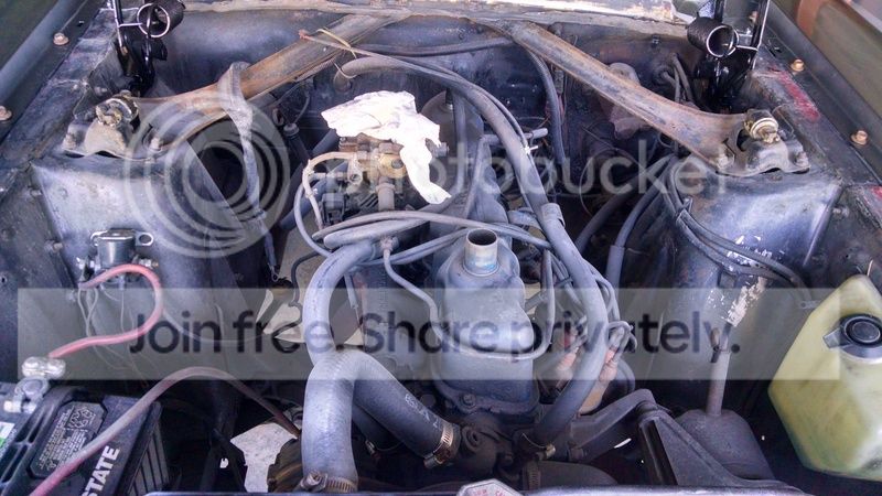

Went up to the unit today and dropped this on;
Also brought a long flat head so I could pop the trunk!
Based on the limited shit I've taken out, I'm not sure much is going to be reusable since the guy crammed everything in. I'll be posting up what gets yanked out on thursday. Might bring the jumper up too and try to fire it up (seriously hope no pun happens!).
