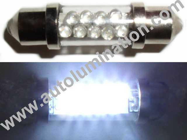

You need to take a very small flat head screwdriver (and by very small I mean tiny) and pry the lens out by the corner, they are not 168/194, they were the tube style (161?)
Thsi is a pic I foudn online of the bulbs once you get the lens off

That's the word I couldn't think of, festoon bulbs

Thanks to both of you, answered my question fully and pointed me in the right direction to proceed.
Follow-up: Looking around online, Im' seeing a few different sizes, i think based on the length of the bulb. Any idea of the right one to go with or should I just pop a stock bulb out and measure the length?

no problem.....just go with the one i posted above.....9 led lights up my car just fine
EDIT: shit im not sure if im accurate on this dude i just saw that its fora vert.....guess i just didnt see that before......you just have maplights on the rear view mirror dont you? that i dont know about......but what joekd posted looks the same so maybe they use the same bulbs in the mirror/maplights as they do in the hardtop dome lights
