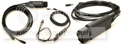

Innovate Motorsports LC-1
9-Pin Mini DIN Cable

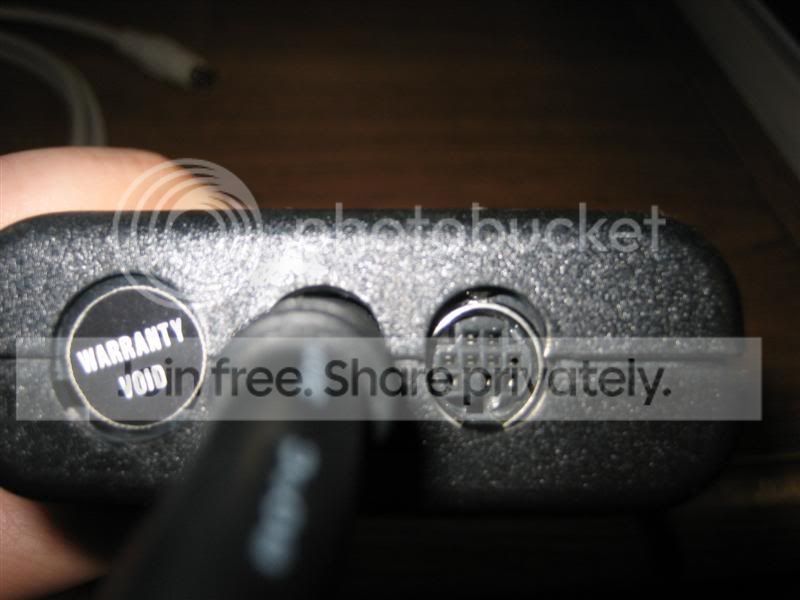

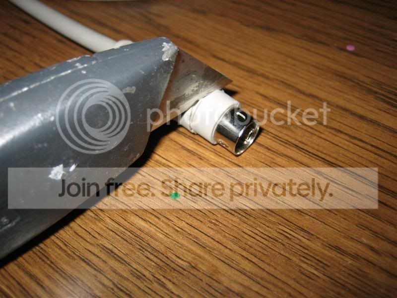

Step 1: Trim back cladding on connector so it will fit correctly into the X-Cal

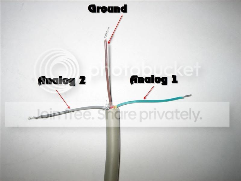

Step 2: Cut one end off of your cable and strip back the cladding. We will only be using 1 wire for this mod. The green wire labled Analog 1 is the one you need to find. * DO NOT GROUND OR USE THE GROUND WIRE. We will adjust for the ground offset or difference in voltage later on.
Step 3: Connect the BROWN wire from the LC-1 to the GREEN wire of your cable.

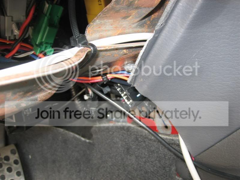

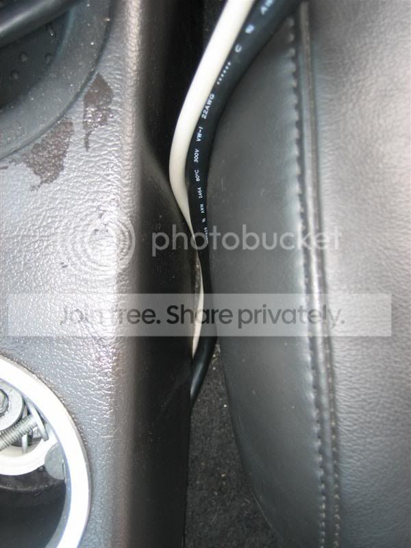

Step 4:Route your cable under the dash. You may choose to run your cable a differnt way. Make sure you secure your cable so that if it gets tugged on that it will not rip the tiny wires. I used a few zip ties to secure mine.

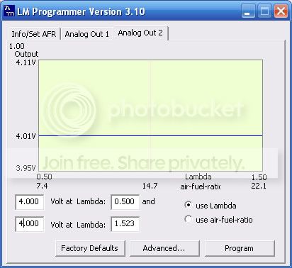

Step 5:Calculating ground offset...Launch LM Programmer (Innovate Motorsports) and select the Analog out 2 tab.
Next...change the high and low voltage values to 4 volts. Hit program and wait a few seconds. You will need to key off and key on for the settings to take affect.
Step 6:Go back to you LiveLink program. Since you key'd off and on for the Wideband setting change you will need to restart your data log session. You should now see a voltage value close to 4 volts. In my case I saw 3.974v
We can now adjust our formula to compensate for the differnce in gound sources. In my case there was a diffence of .026 volts (4.00 - 3.974 = .026) between my X-Cal 2 reading and what the LC-1 was outputting.

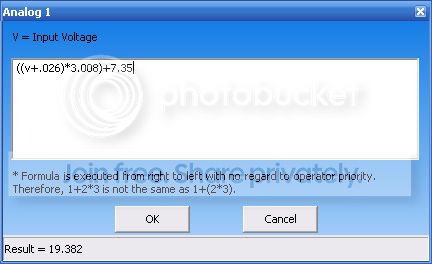

Step 7: Entering formula for Analog 1...double click on the Analog 1 and it will pop up the formula input box for that input. Enter your formula and hit Enter.
Use this formula --> ((V+X)*3.008)+7.35
X = your voltage offset...in my example my value for X was .026
Once you apply your formula you will now be seeing your actual A/F level. If you have the XD-16 gauge from Innovate Motorsports you can compare the readings. They should be identical.

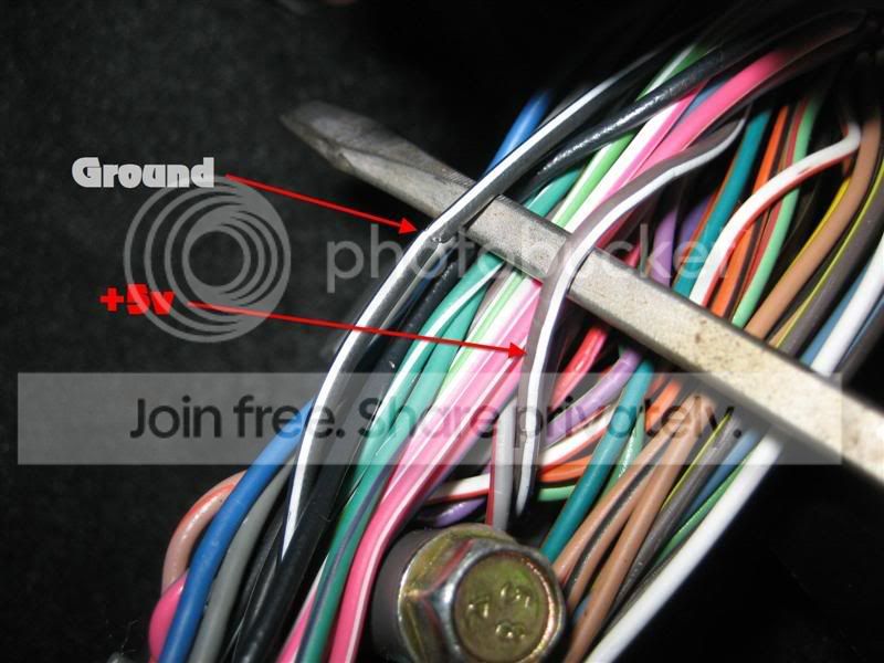

Step 1: You will need to find a 5v source to power the MAP sensor. I spliced into the factory EEC harness to get my 5v reference and ground. Pin 90 which was Brown/White is what I use for my 5 volt source and Pin 103, black/white, is what I used for the ground.
