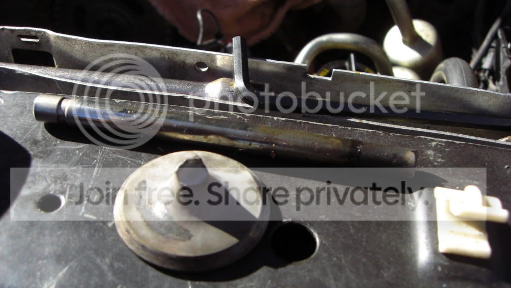

Okay long story short, i bought new timing set, advance cam 4 degrees turn motor over(by hand) and hear a snap(dumb i know) :nono:. Notice 1 valve spring higher than the rest, pulled head portion of valve was laying on piston while other half was still inside the head. How do I measure the valve to replace it.

I'm not positive how they measure it but when you do figure out how they are measured, I would measure a non broken valve, a snappd valve may have deformed slightly before breaking therefore not giving you the exactly measurement you need.

Yeah I pretty much decided that during the day, pulled both heads off and taking it to the machine shop during my lunch break at work tomorrow. Thanks for the tips. I have one question though. Since this is obviously a PTV clearance issue how should I best address this issue as of right now in your opinions? Should i
A) Notch the pistons for better clearance
B) Get a set of SHORTER valves
C) A+B
I dont have the funds AT THIS MOMENT, nor is it my intentions to have the block removed and put in forged pistons, new bearings, clutch, etc....
