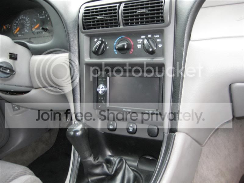

I'm happy with the way mine came out with a simple dash bezel swap from an `04 and slight mod of the dash structure.
took about an hour, I don't have a finished pic but I dyed the bezel black and it matches the dash/shifter now...

that is nice. the buttons on the bottom are a nice addition. are they functional?
Blind
Feb 2, 2008
473
the "traction off" is actually a push button engine start now, and I'm looking to wire up the indicator lights on the defrost and trac buttons to show the high/low speed fan operating, but they are not functional like in the `04 I got it out of.
