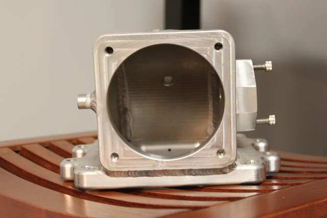

Thats what im using. Last year I had the Trickflow upper plenum. The best conventional upper plenum and throttle body is the Accufab its the choice of guys who need every last hp

I used to have an accufab plenum on my old setup, but now use a 6061 race plenum

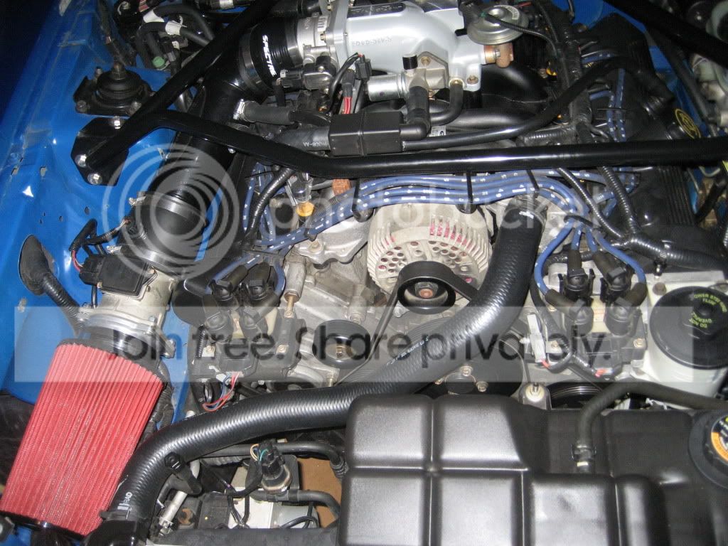

As far as hp improvements go, yeah just a couple of hp. I went with the TF for the price and quality since the other standard ones were tested/rated very similiar and a good friend supplied a 70mm tb to go along with it. So it looks better than stock and adds a few hp with only a little work and coin.
reference and pics.....
http://www.modulardepot.com/articlesp.php?aid=38
TF plenum pics:

I dont like bbk stuff really. I only ran their h pipe on my car last year. If I had to chose and it wasnt an elbow like I have now, it would be the Accufab t/b plenum combo.
