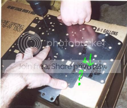

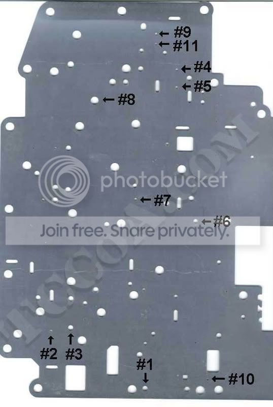

Right on. I just printed off chapters 13 and 14 from the "transmission 101" section which are "modifying the main control, part 1 and part 2". I also printed off the "Modifying Valve Body to Jerry's Specifications" article by A-Train, but I didn't print off the "A-Train's shift kit install" one. I noticed a few discrepancies between the how-to's from Jerry's "modifying the main control" parts 1 and 2, and the A-Train article. I can't remember them off the top of my head (it was late last night when I was reading), but on of them has to do with the markings A-Train had on his separator plate. He had an extra hole marked ... see below ... Jerry's picture does not show this hole marked off. A-Train has it marked off as #4, but #4 in Jerry's article is the one right above # 5 (which A-Train has circled, but not numbered) .... ?

Jerry's plate is a '98 and his marks are correct (as if there could be any doubt, lol). A-Train has "4" marked above "5" but he also has a third hole circled near 9 and 11. Do not touch the third mystery hole. 4 and 5 are circled in green in your mark-up of A-Train's plate picture. You can use A-Train's plate to find "8" on your plate because his plate is earlier than a '98 and, conveniently, "8" is marked on his plate. Your plate ought to look very similar to the '98 plate in Transmissions 101. Don't drill bigger holes than necessary or the shifts will be harsh. This is a case for bigger is not always better.

Jerry's thesis has a quick one-line blurb at the end of the "2-3 shifts" section that concerned me. Referring to "hole 6" which is the "direct clutch exhaust" hole, he says "the larger direct clutch exhaust hole is only recommended for transmissions with the mechanical diode intermediate one-way clutch. The larger exhaust puts more stress on the one-way clutch and may cause premature failure." But just before this blurb he says "if the transmission does not have a mechanical diode..., open this hole to .125". If it does have a mechanical diode, open it to a slot." So which is it? Open the hole up, or not? I know I don't have the mechanical diode, so I know the "slot" is outta the question, but do I open the hole at all? Am I reading it wrong? Any ideas?
Also, is it necessary to replace accumulators? I'm guessing this is a "you might as well because you're in there already" mod, right? I'll play it safe and replace 'em I suppose.
Lastly, Chris, you mentioned "hole #8" in your previous post ... from what I understand that's only for '95 and older ... ?

Open the direct hole to 1/8 (.125)
If your accumulators are alluminum, ditch them for rubber.
You still have hole 8, it may be an inch lower than the pic though.

But Jerry's write-up states: "if you have a 1996 or newer 4r70w you do NOT need to modify your forward clutch exhaust orifice .... hole #8." I'm driving a '97. So leave 'er alone, right?

Your transmission (pre-'98) does NOT have a mechanical diode so open the hole to 1/8", as J.R. said.
