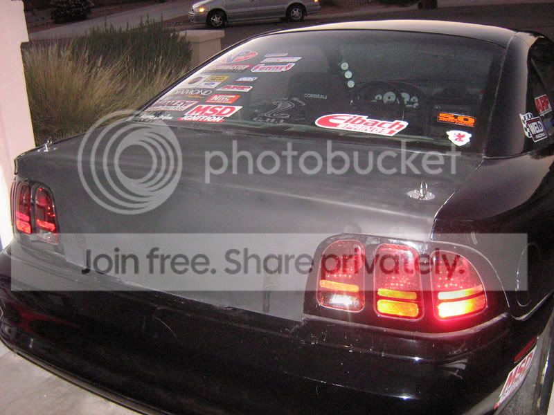

well i got my weld draglite front runners finally, and i got my vfn fiberglass trunklid on as well, i still need to do a little finishing touches on the trunk witch was no easy feat to put on lol. Also im doing some interior work im fabbing some pieces up for my dash to hold my msd rpm switchand my nitrous progressive controller, ill put picks up of those later if anyones interested. Not the best pics yet the cars kinda dirty and i got not the best angles but i wanted to show you guys...
also im finally getting my 28-10.5 slicks so it will definetely fill my wheel well better than these 26-10's....

so what is under the hood, what kinda shot?
and i see those coilovers on their, i'm guessing you have the whole QA1 tubular suspension?

With that many racing decals on the windows, that mofo must be fast. ;)

hay thanks for all the great feedback guys thats why i really love this site, i just got back from the hospital because i just had my first child a baby girl!!!!!!!!!!!!!1 :banana: :banana: :banana: :banana: so i read these and its great to get good feedback. As far as the engine
stock bore and stroke
diamond custom 10.5:1 pistons, manley h-beam rods, stock crank knife edged balanced
d.s.s main girdle, all arp hardware head studs main studs
fel pro gaskets
heads ported and polished, full fr500 valve train, cams are also fr500
intake manifold ported by sean hyland motorsports
custom direct port nitrous setup done by the man himself Mr. Sean Hyland
driveline.
tremec 3550 , might switch out for auto sooner or later dunno yet :dunno:
aluminum ford racing driveshaft
moser spool
superior 33 spline axles with c clip eliminator
4.10 fr ring and pinion, fr diff. cover with girdle
suspension.
QA 1 tubular k member and a-arms
lakewood 90/10 struts with d and d coil overs
gripp caster camber plates
rear:
strange 12 way adjustable shocks
eibach drag launch springs with airbag
bbk upper and lower control arms
kenny brown full lenght subframe connectors
i originally was going to run straight bottle like a 250-300 progressive shot with maybe a secondary kit, but i started to change my mind. Im talking with the guys at amp and were going to put some boost on her, im leaning towards a hellion turbo kit, there a dealer for them. This car will never see pump gas wich is why i can get away with the compression, so thats it and yes im hoping itll be a bad sob lol i guess time will tell thanks again for the feedback guys :thumb:
