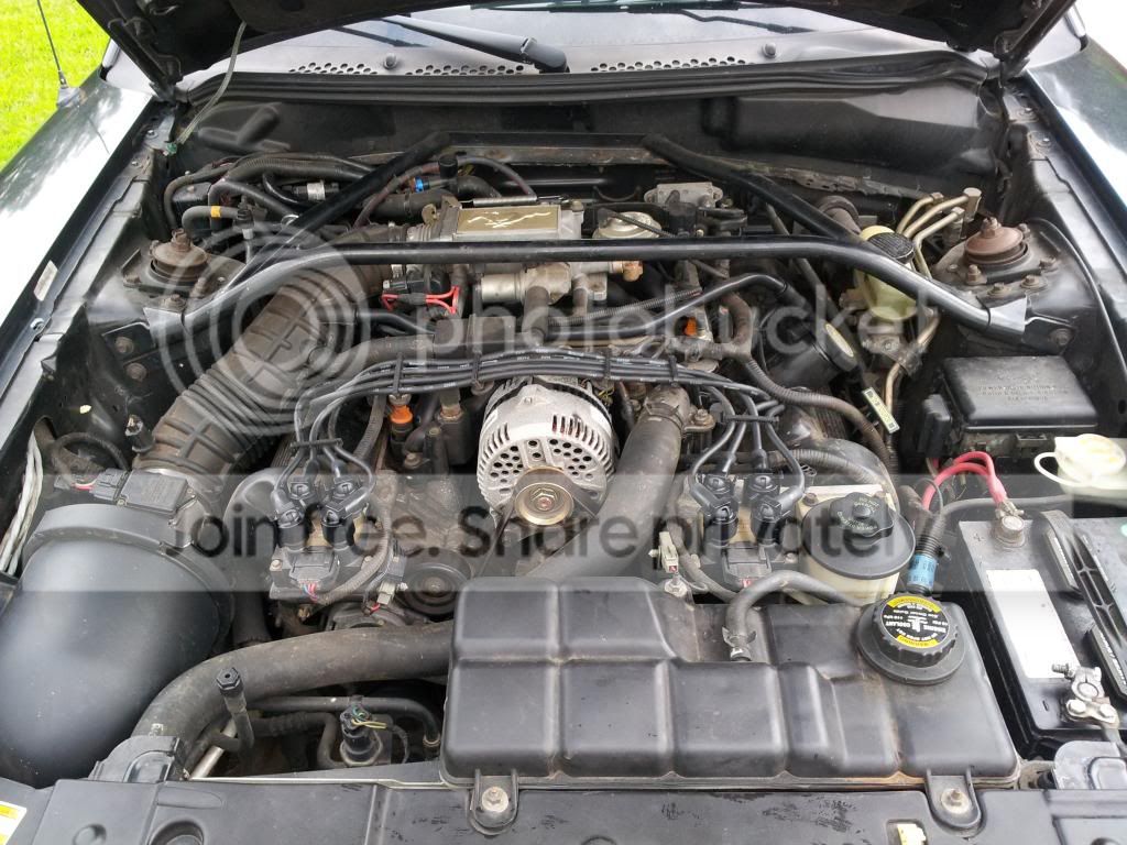

I'm not sure if there is a thread on this or not yet, but my engine bay (pictured below) still has the oil from the past 140k all grimed up in it. I took a rag to a few parts, but there's still a lot on it. I have access to a pressure washer and was wondering what I would need to do to pressure wash the engine. Is there areas I need to tape off, put bags over, not go near, etc..?
Any Information in regards to the process would help a lot! :grin:

If it were me you really arent going to get it looking amazing unless you remove alot of stuff and clean it BUT ! DONT LOSE HOPE! if you can get ahold of a hot water pressure washer one of them you can put detergents in and put some quality soap in it and maybe spray some Engine Brite degreaser the foam kind and I would say it would look pretty good . I believe you can rent those hot water pressure washers might have to check in to someone in your area . Just watch spraying the engine brite on your warning label stickers its really strong and will take the writing off lol . Tape a trashbag around your coils and throttle body and any other electrical connections that may or could be bothered I would also remove your air filter housing to gain access to more of your engine bay . Hope I helped !

Why pressure wash at all? Just use degreaser, a stiff brush and a little bit of elbow grease

This. It doesn't take a lot to get the engine bay clean. Just some time and the right tools.
1) Cover your alternator, fuse box, and CAI with a plastic bag
2) Soak the engine bay in a degreaser. If there is a lot of built up gunk you can always run the engine for a little before you start to help the gunk to losen up
3) Use a brush to agitate the build up
4) Then carefully spray down the engine bay with a hose
5) You can then use either a towel or air tool to get the excess water
6) Apply a dressing to plastic parts for shine
