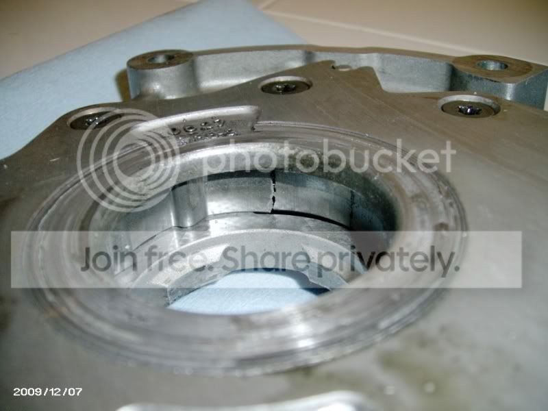

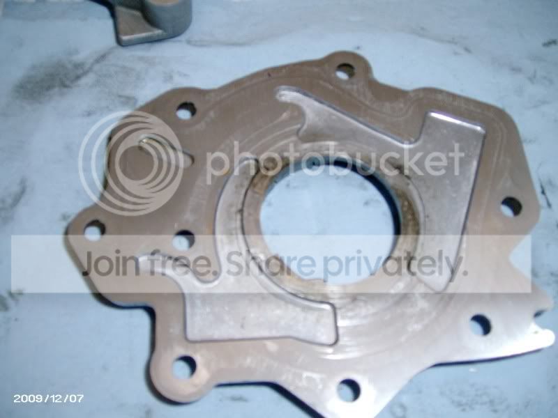

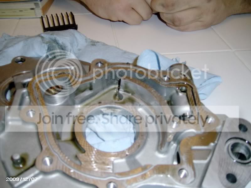

My friend had a Modular Mustang Racing street/racing oil pump fail on him.
It ended up costing him a engine.The oil pumps that Modular Mustang Racing
sells are obviously inferior.After the oil pump failure it was in peices and we
inspected it and come to find out there was no debris ingested into the pump either!

That was a common issue on 4.6 oil pump gears a few years ago, stock-MMR-SHM etc were all having problems with the billit and stock gears.
The problem sometimes comes from the wrong dampeners/balancers being used and vibration destroying the pump gears. This is why people say never use the piggy back style UD Pulleys on modulars.

Sean is one of the 3 people I know of that had their mmr pumps cause catastrophic failure at 600+hp. The Cobra pump is so much better for the average builder. IMO if you're over 700, you should have an external pump to be as safe and efficient as you can. Which is what Sean is doing now.
MMR is a good company but they have a few issues that should give concern. Like this pump and that they nickle and dime you to death if you want extras. Their logic of NA cams being all you need for blower cars is pretty screwy as well. My mmr shortblock is great thus far and when I build the next engine, I know to do it all myself just for piece of mind.
They also think they are going to pull 500rw from an NA 2v too, which is pretty ridiculous.

The MMR is just a Ford Cobra Pump stamped with MMR in it. The differences with all these pumps is the gears.
You have stock, MMR Cryo treated stock, and Billet Gears as replacements.
