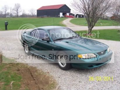

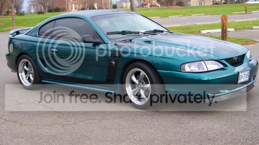

Wow, "F'n A"! Awesome- Welome to the forum, you have a great car to work with! I have a tone of questions in regards to how that thing runs and how you like it. We have simular cars, mine being Pacific Green-
Looks like the transformation pics I posted earlier kinda-

I don't know how much power it makes I have not had it on a dyno yet but it may be a little bit higher then Robb 15033 stated, it is 10% over driven on the supercharger has 70mm mas air and tb with ported blower intake true duel 2.5 Exh and the 373 gears. It does run pretty good the way it is but we never have enough. I have tuner program in it but it has not been dyno tuned yet. I have some 42 lbs injector to install and need to get a bigger fuel pump before having it dynoed. There is a lot that I want to do like port the heads and maybe a good street cam do the jmod to the trans and get a stall converter. I want this to have good street manners and still make good power. I am getting old and I like to have the good drive ability.
By the way the vice grips are no longer on the battery cable just there until I go new ends. LOL​
