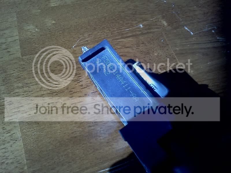

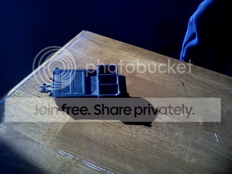

I received my 5.0 harness/EEC combo today and have a relay/module that needs replaced and I can't figure out what it is. It was plugged into the fan harness.
Part #: F5DA-14A411-AA 312-2
I can not get the PN to bring anything up. So, if any of you guys know, I would appreciate any info you have.

That should separate on the back were the cables seem to cut off at. Not sure what it does i've heard people running without it. Also heard of not having it causing the wires to over heat and melt.

So, your saying you think it may be some type of restriction to limit the amperage in the cooling fan wires?. Hopefully somebody can chime in and give me some more specific info.

Well, just found out what it is. Its a circuit breaker that Ford installed as a band-aid to fix a cooling fan overheating issue.
Its a "CBM", Circuit Breaker Module??
But, as you said rz5.0, some work fine without and some don't.
