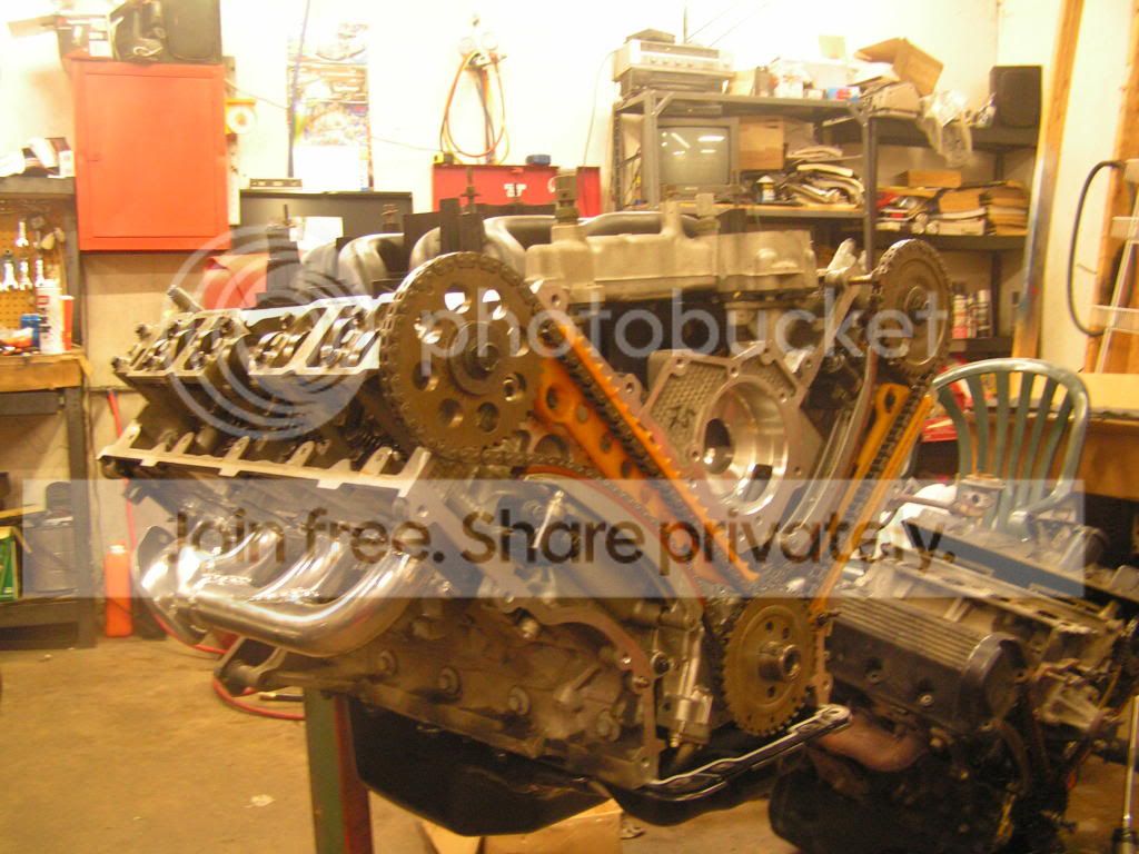

New adventure, wish me luck.
B
Brian
May 16, 2008
199
Got my valeo king cobra kit in today.....ordered headers and gaskets.....have everything I need by friday (I hope)

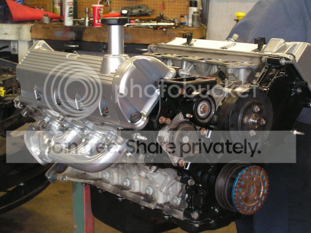

They fit good, car sounds really good. I have 4.10 gears and I need to go back down to like a .373 or something, it wraps up so much faster than stock. I run well over 100 MPH in 4th gear, and a good deal before the 1/4 mile mark, need to have some longer legs! Here are a few more pictures:
Oh, and temp sensor in head is NOT used at all. Car runs just as smooth as it did before.
