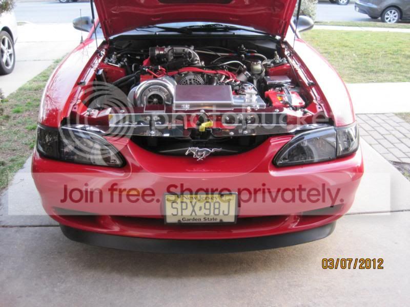

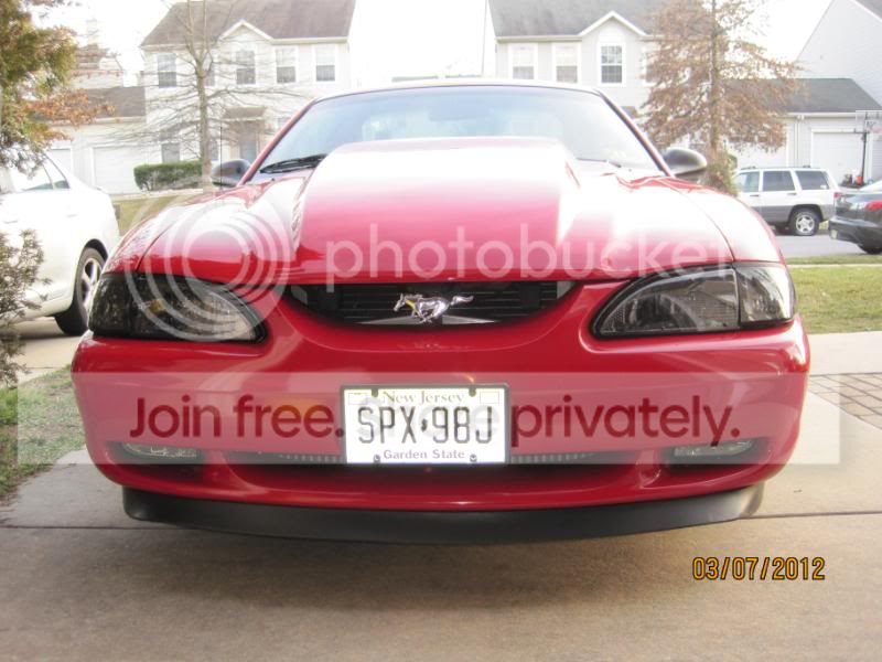

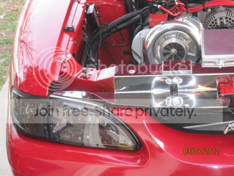

Got my new smoked cobra headlights in, also went with a smoked clear corner bulb instead of that ugly orange one.

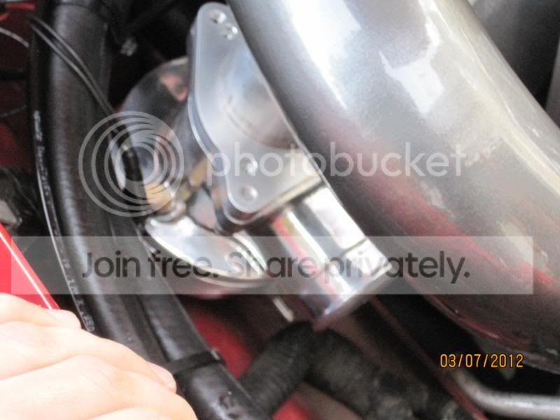

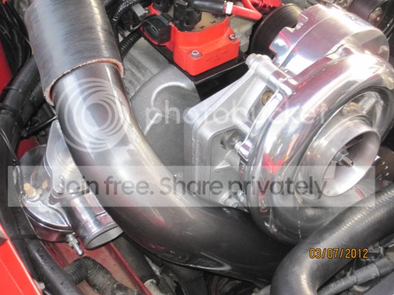

In process of swapping my mini race bypass for my mono bypass, some pics of the progress:

It looks weird finally seeing your car with 2 piece headlights.
It looks great though Mike! Very nice switch..

thanks for the nice words everyone, I must say its wierd seeing my car with 2 piece headlights as well, Ive had this car for 5 years and always had 1 piece's in

thanks a lot fellas.
at first I was kinda iffy going with these, every single mustang has them and the fitment on the ones I did see werent the best, but I'm happy with the final results
JerZeyStangz
Jan 13, 2006
3,615
45
Northern NJ
another tip, adjust the tabs on the headlights so it can be flush with the corner lamp. The tabs that are next to corner lamp just has to be adjusted slightly. Best way to do this is just pop the corner lamp out, use a phillips head screw driver make sure you get the right one to not round the phillips head and screw it in to aim down, screw out to aim up. This will adjust the bottom part of the headlight. The top tab above the head light needs to be turned by hand, and the inner tab thats at the corner of the light near the running pony needs to be adjusted by hand. I've messed with so many headlights that I can see when they are out of alignment lol. I use the corner lamp as a guide to get it looking flush.
