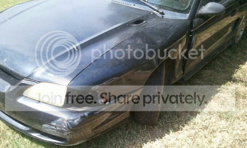

Got the car home last night!
J
J.Cagle
Jul 26, 2012
179
kansas
I know its not much but I picked it up cheap. Its go 100,000 miles. 5.0 5 speed. power everything, tan leather interior in ok shape. I drove it about 45min home and it did just fine. Seems to have decent power, but when I get on it much has a very slight rattle. Hoping its nothing major. Needs an oil change really bad, maybe that'll help it some. I found a set of the factory gt wheels like what it has on the passenger side for $200 with nice tires, and I picked up a nice black hood for $100 the other day. Planning to get this thing looking nice again as cheaply as possible. Once I round up all the parts Ill get them on and repaint the whole car. I do paint and body work so I wont have much time in it.
