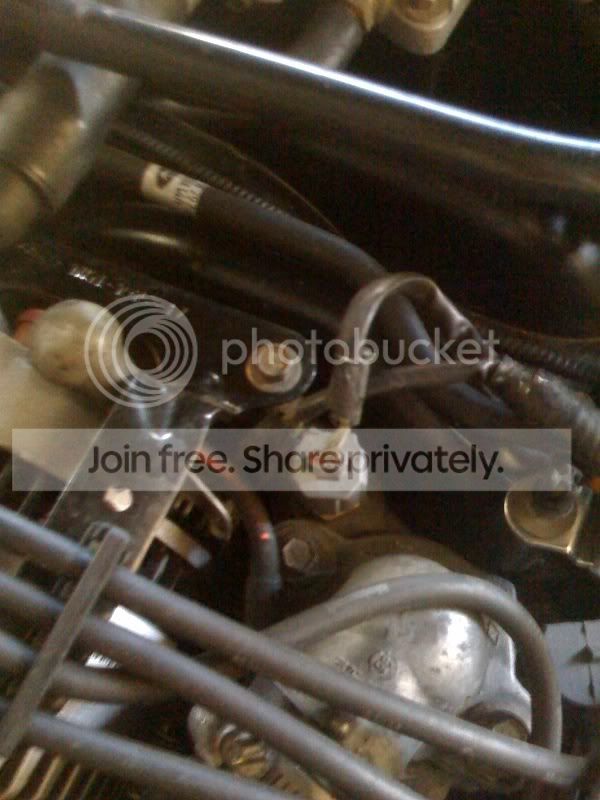

Kinda give you idea,( Its the gray sensor right beside the alternator)

Ok I know where it goes....What kind of shop do I go to a machine shop?And can I see some pix of the one your selling I am in anaheim,ca,is it possible to lower the price and I will trade you for my pi intake???

Yes, go to a machine shop. Unbolt the crossover itself (6 bolts) and bring that and a temp sensor with you
Show them the sensor, point to the area in front of the thermo housing and say need it in the center of that flat section
