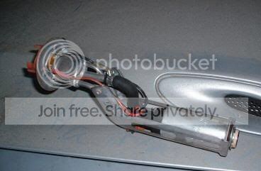

You can pick up a Focus svt pump for like 89 bucks and it's a 255lph pump.. the difference in pumps:
96/97 Gt's
98 Gt's
just buy a Focus SVT fuel pump and remove the actually pump itself and place it in your housing.. that is all that I did
EDIT: Hope this helps

Wow that that made my life easier thanks for the pics man, were you get your focus pump

yeah, just go through Ford they are under 100 bucks for it and it's a very easy mod just drop your tank and i didn't even disconnect all my hard lines just pulled out the housing and then removed the pump and replaced with the new one.. you'll get the entire assembly like the one in the picture and you can remove the focus pump first to see how it's done...
really is an easy mod
