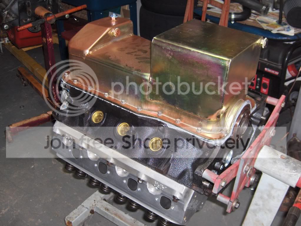

Does the Proform pan hold any extra oil over the oem pan? And isn't the stepped out bottom area of the Canton pan what makes it a "road race" pan? Isn't that wide base area to ensure proper oil level at the pickup tube even in high-G turns? So what makes the Proform road race pan a road race pan if it doesn't have the stepped out bottom area?
It holds 7 quarts. I would rate it at in between a stock pan and say a Canton because it does hold extra oil and it does have baffles to help with oil slush. I've never seen a Canton in person but they're suppose to have trap doors in it which would make it better then the Proform. If I had a true race car that I competed in and I had a real nice race engine then I would've spent the extra cash for a Canton but because I don't plan on competing anytime soon and I use a decent little engine I decided that the Proform was more then enough for what I need it for. It's just another option.

I thought I took pics when I installed mine, but guess not. This is a stock photo, but you get the idea.
I raced with a OEM pan for years, the Canton definitely helps with oil starvation. Hard and long right-hand turns you'd see the oil pressure drop to 10 or so, not after this pan. Pressure was rock solid through the turn.
