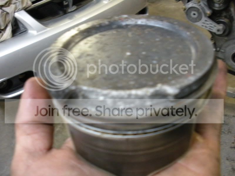

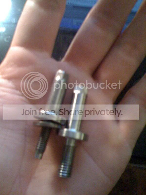

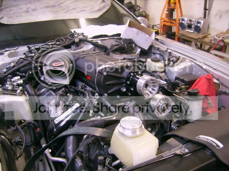

I have been building the turbo setup for about 4 years now. Its been expensive is the reason for the slow rate of work and progress. Car has had a ported eaton, 2.2 kb, 2.4 kb and 3.4 whipple on it before the stock motor let go lol. Pics of the whipple setup and the runt of the stock pistons

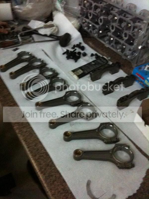

Some pics of the motor build. Teskid block, cobra crank, manley I beams, diamond pistons. Heads are livernois stage 3 ports, oversized stainless valve, pac springs and accufab flipped tensioner and bigger chains

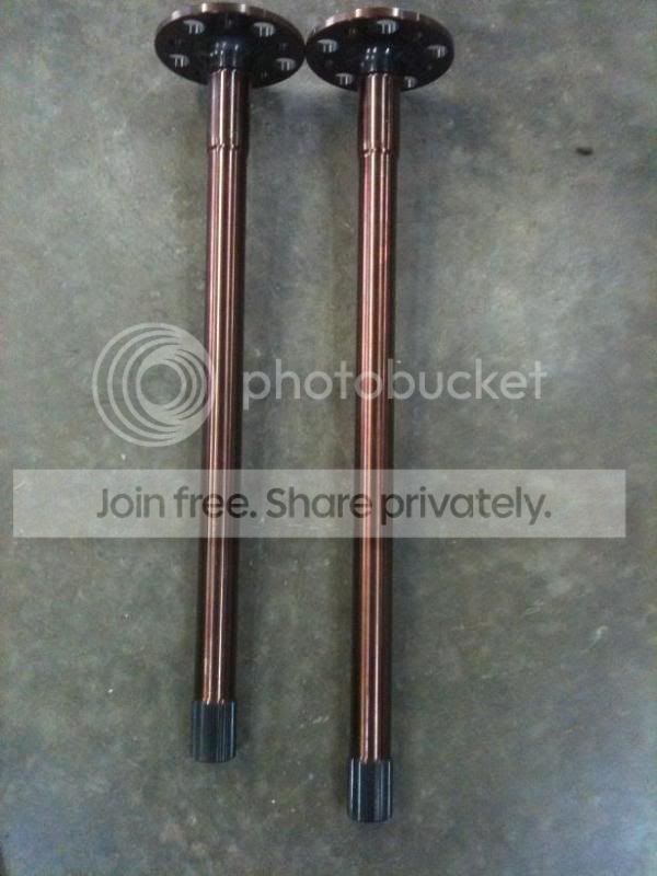

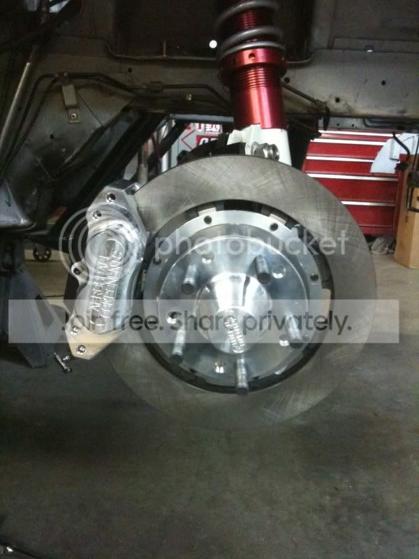

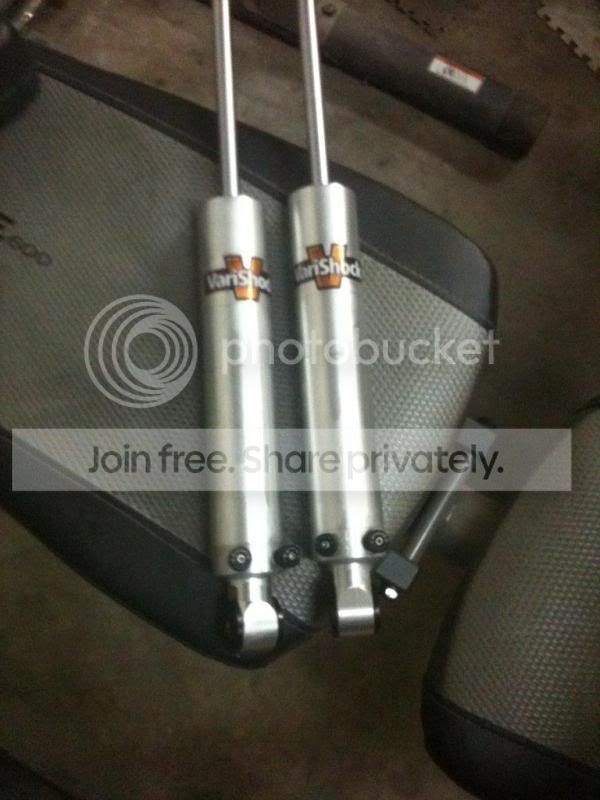

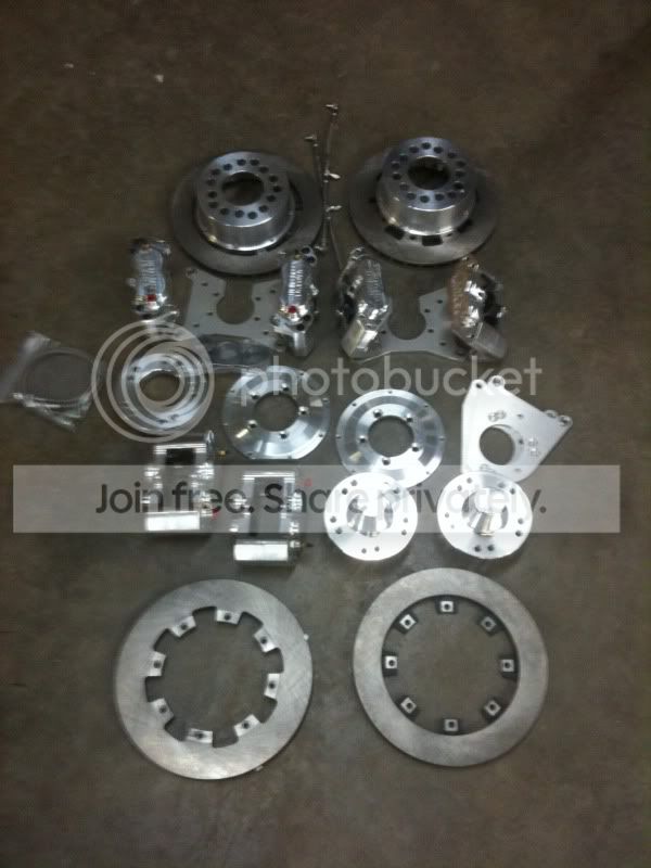

Some of the suspension and brakes. Aerospace street brakes with dual rear calipers. Tokicio drag struts and coilovers, double adjustable rear shocks. Rear is strange ultra case, and 40 spline axles

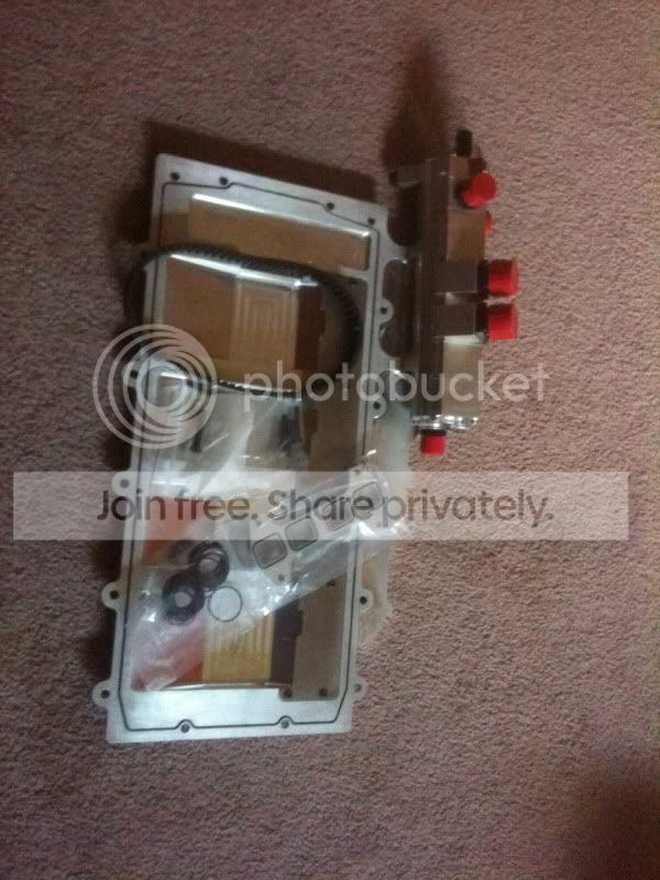

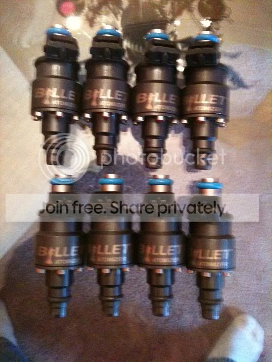

Some more motor, berry motorsports billet intake, alan kenney billet atomizer injectors, fast standalone and dailey engineering dry sump
