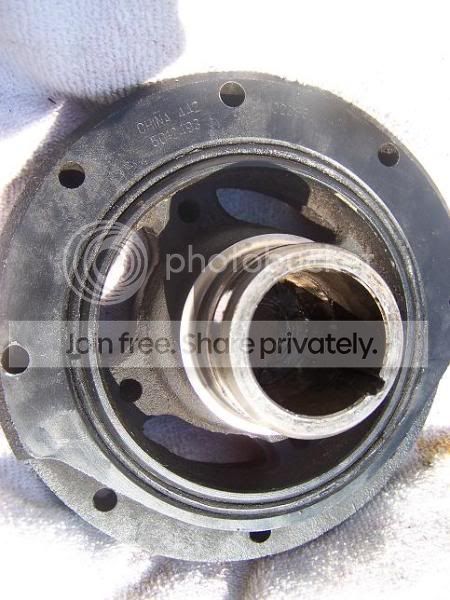

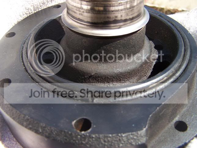

Pulled the old one off to check it out, What do you guys think??? Doesn't look too bad to me :dontknow:!

Might as well replace it while you have it off. If your car has high miles, it is likely going to be time for a new one soon anyway.
Installing it with an impact is the wrong way to do it. If you damage the threads in the crank, or snap the bolt, you'll have much larger problems than a bad balancer. Get an installer tool.

I totally agree with Paul. You already have it off. And the rubber looks a lot farther out than it did on mine, and it shook like hell! I went with stock replacement - have not had any problems with it yet and it runs smoooothe.

If you look at the pics you can see the rubber is further out on one side you def need to replace it. Yeah do it all by hand thats the way to go
