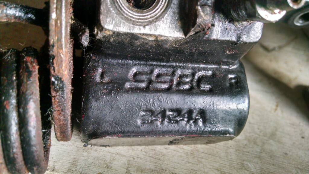

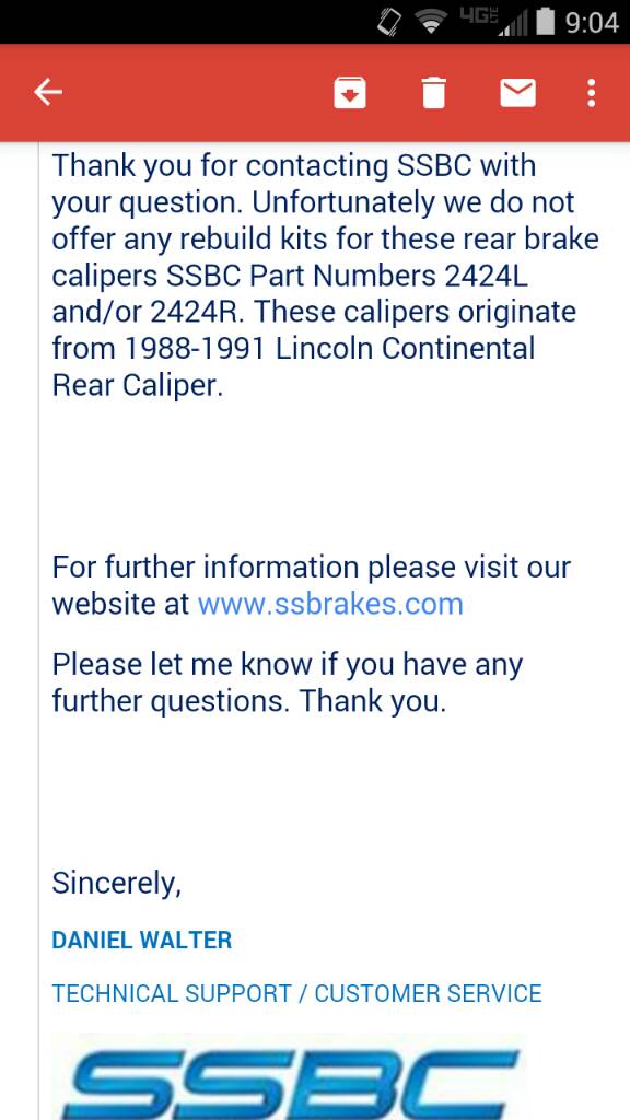

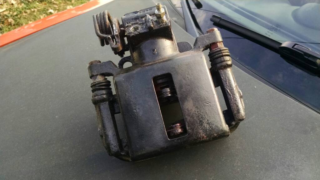

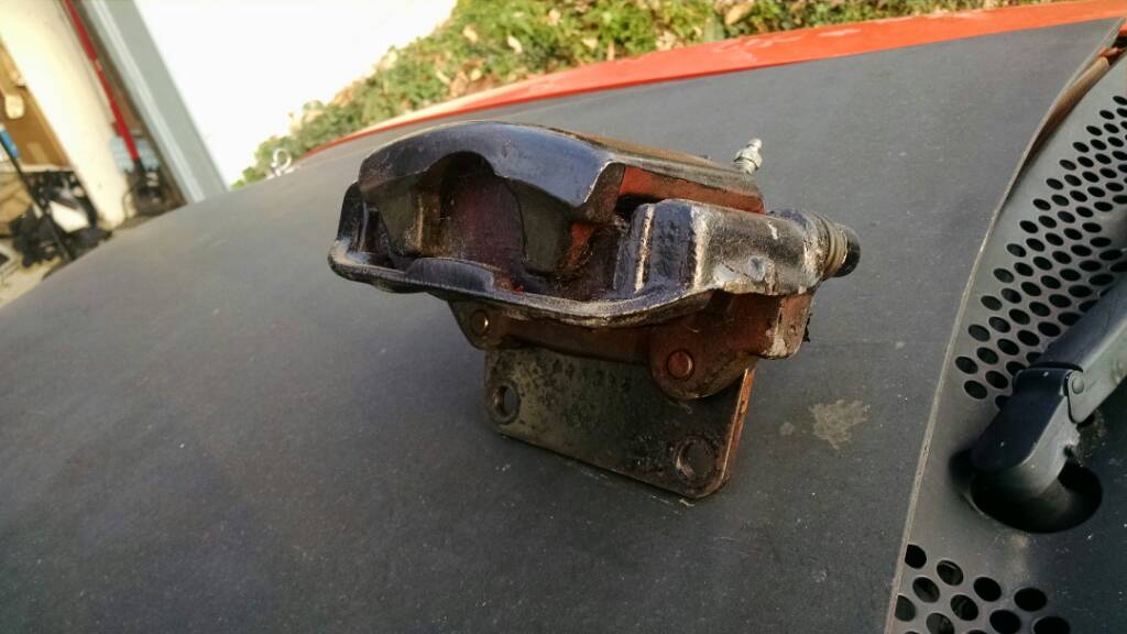

Well that's ironic. I was just on here to see if there was any info on the rear brakes. I just picked up a set of cobra fronts and a complete SSBC rear kit from a buddy. Turns out they're just Lincoln Continental Calipers. Still curious on how much better they are, if at all.
Sent from my iPad using Tapatalk
Rear Lincoln calipers? Post pics I am curious...
that brings up an interesting idea Though... maybe I will start compiling some info on rear BBKs..

Caboose302
May 19, 2013
1,601
Dayton Oh
Excuse the dirt. They've been in storage a while so they're going to need a good cleaning and some new paint.
One of the calipers is leaking so my buddy emailed the company about a rebuild kit. This was their response.
