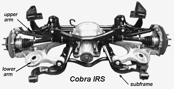

ok...so heres an IRS. i'm assuming yours is the same?? if you have tubular control arms...no. stock control arms then it should work fine. i would not hesitate to grab this. the bag mounts may need to be fab'd a little though. no way to b sure unless you have it in front of you, lol.
bags mount directly in the CA's where the springs would be. they should sit right in place.
