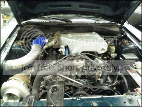

Some dyno numbers from my 342 stock block.
shaunk
Dec 16, 2007
85
Well we finally got it in the car and running! I switched the car to efi. This run was at 7 psi of boost from a 67mm turbo, with 15-16 degrees of timing thru an aod! It still has a stock fox throttle body and spacer on the intake. Theres quite a bit left in the car but the owner (me) is getting nervous and we'll probably not push it alot further maybe a little higher in the rpm range to see where it levels out. The combo is vic jr heads,harland sharp rockers, trick flow track heat upper and lower, Jay Allen tlsr. Plans that are allready in motion, I got a much bigger throttle body and spacer, 76mm turbo, and stuff is getting coated. I'm gonna take it too 600ish this spring and see how long she holds up. Hoping to be deep in the 10's as it ran 11.50's n/a.
