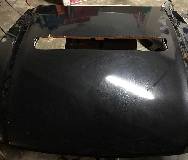

heres some pics from my gt500 hood vent install. since the projected temperature on my track day in august was 103 i wanted to make sure i got as much heat out of the engine bay as i could. granted i was blessed to have the high drop from 103 to 96, but it was still very hot out there as well as on the track itself.
i started by taking a lot of measurements and marking with the tape. [MENTION=9209]ReplicaR[/MENTION] helped me out a whole lot especially when we got on a live phone call. the project didnt take too long, but it was rushed since i had about 8 hours to finish the project before i had to wake up at 4AM to get on the road. i also was doing new brake fluid and pads earlier in the day so it was a total track day prep
but heres some pics off the IG since i dont have them on my phone anymore to upload to flickr
why the pictures are being weird i dont know
after i made the template for where i was going to cut the hood i drilled holes all the way through the hood along the area i was going to cut. after drilling the holes i used a dremel and cut along the lines. honestly this part did not take that long. the longest parts of this project were measuring for cutting the hole and then using the expanding foam because it has to dry and cure.
after my actual track day i wanted to make sure i got out more heat as well as stopped water from getting on important parts like the coil packs and the alternator and belt. so i made a shield of sorts
again lots of measuring and fitment testing with that aluminium piece. im not done with it either since i have to take care of the 2 outer sides of the vent
