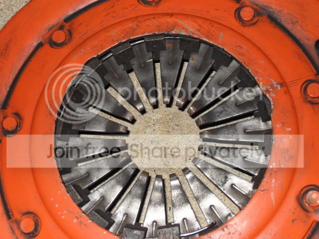

My centerforce DF lasted one year with zero track time. I'll never buy another one thats for sure. Although matched with the fidanza aluminum flywheel it was nice and easy to drive. When I replaced the centerforce the flywheel looked mint but I changed the core of it anyway because I was putting a new clutch in.

you know the ring that holds the weights together? That thing broke on me for no reason at all. The weights went flying.
