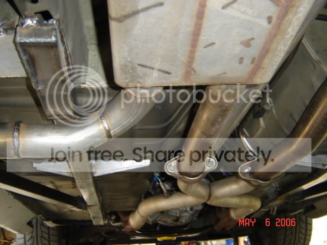

Call Spintech... they sell full length subframe connectors for our mustangs. They are stepped. Most Roush owners run them in conjunction with our stock SFC's. Weld them to the spintechs and they are triangulated for the strongest setup. Its something I've been planning on doing since the stock SFC's don't do much.

I'll see what I can find on the Roush Site. As far as through the floor subframes, I know that Griggs Racing SFC's are but it obviously requires cutting of the floorboards...

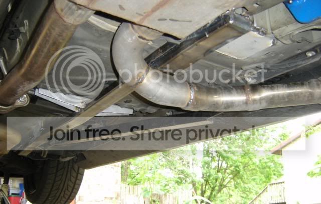

sub frame connectors with side exhaust
Spintech SFC's with the Roush SFC welded to it.

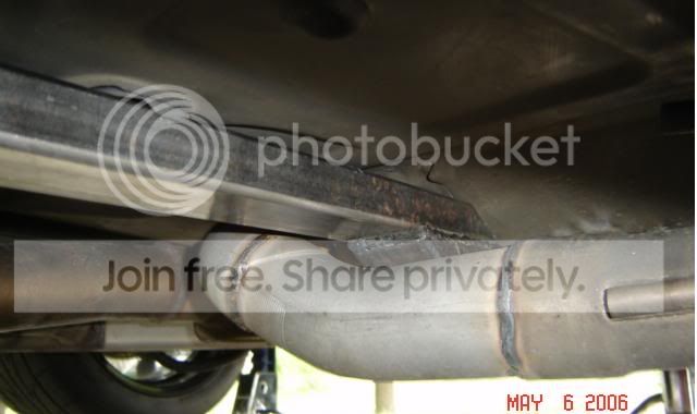

OnyxCobra said:
MadStang you ever scrape that exhaust pipe where it goes under the SFC?
I've never scraped my exhaust itself and it's low as hell. only thing I've scraped is my front bumper lol.
