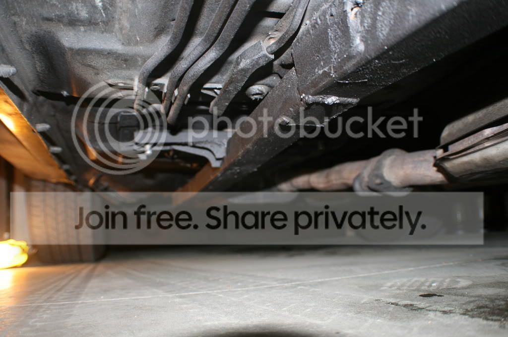

He got the subs from MM. After watching my brother do the welding, the gutting of the interior was overkill. Def use some primer. The instructions suggested weld through primer. We couldn't get a hold of some though. So we primered before and after. Here's some pics:
