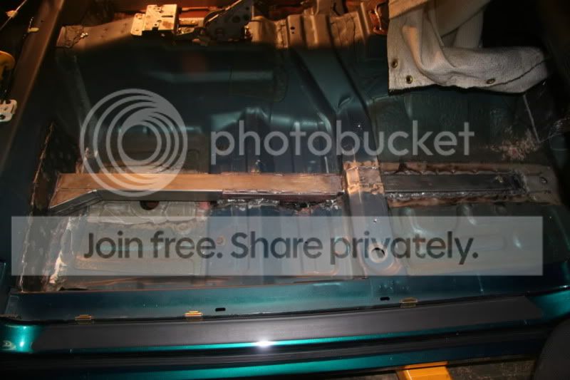

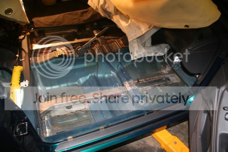

If you want to get a stiff, go with Griggs World Challenge Frame Kit along with lower frame kit. This is the same one that I am going to put on my 95 Vert. They are expensive but worth it.
http://www.griggsracing.com/product_info.php?cPath=4332_4310_4348_4321&products_id=213
Here is a picture of the World Challenge Frame Kit inside the car. The carpet in the rear floor board would go under the frame rail.
I looked at Griggs. Their products are top shelf! Your car will be tight for sure. I think they had a roll bar for the FOX bodies a while back that tied into the upper seat belt mounting points for added strength, pretty smart idea. I am looking for something that doesn't require so much surgery. I just want to stiffen it up as much as I can without a Roll cage. I have kids that don't want to crawl through a jungle gym to get into the backseat.
