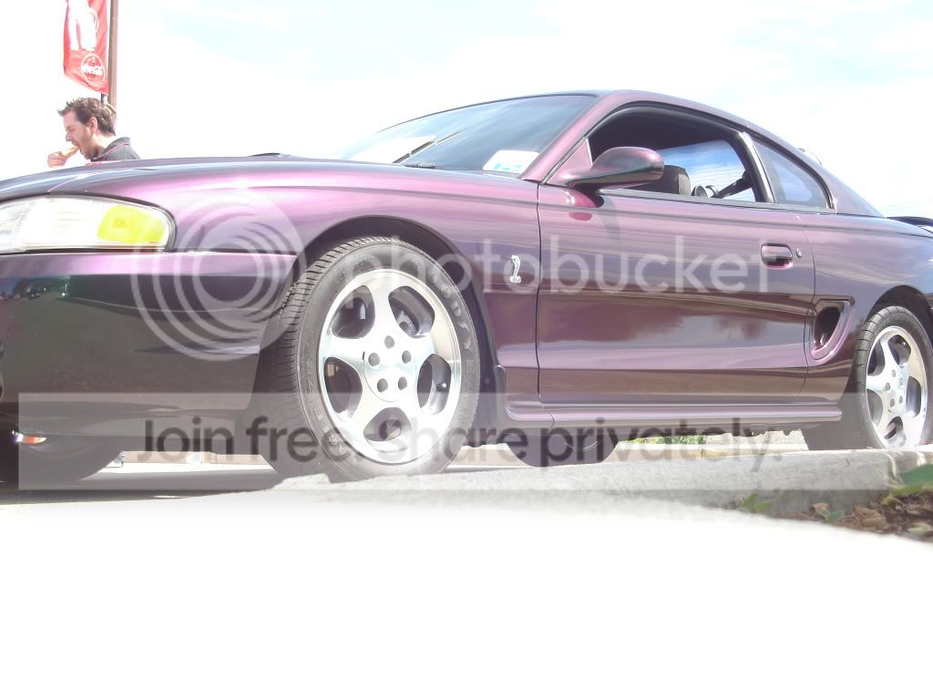

heres a pic from 2 years ago... 245/45r17 up front and 275/40r17 in the rear... as you can see the rear tires are balooned out insane!
and heres a pic from last year... 245/45r17 in the back oem rims are not offset enough with a skinny 245 in the back! i need this pony to sit right!
