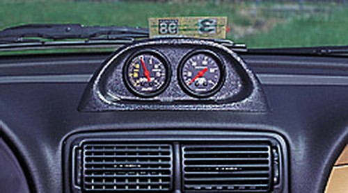

Does anyone know if they make a trans temp gauge that mounts on the dash in the factory clock pod? That would be a cool place to put it?

Autometer?. Have heard of a piss poor fit to dash.
I'm a gauge freak. This works for me.

I'll check around but wanna try to keep it stock looking. Will see what's out there but likely won't really need one with how mild the car will be

Saleen used to make a dual gauge pod that fit in the clock spot (94-97, of course). They used the small size gauges. It was a little "bulbous" looking as it stood taller than the clock pod but it worked. I'm sure AutoMeter makes a gauge for it if you could still find the pod. Click the link to see what a quick fleaBay search found.

Thanks
