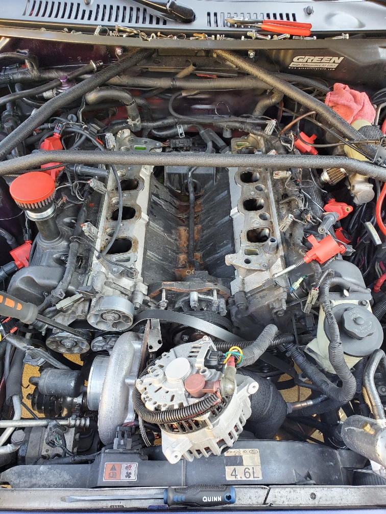

Ok finally the Victor jr Intake and fuel setup is here. I been dieing to make this swap so here we go!

After almost 28 hours its in and running.
There was so hiccups that no one or anything said but I have figured them out and well installed and ran the car.
The NPT fittings were my dumb fault i.forgot to add teflon so they leaked.
The strut bar was in the way I decided to remove a portion lol and later weld and bend around it.
The oem feed fuel line and the fuel line from the edlebrock were so long that it was kinky everywhere so I decided to remove so of the oem fuel line and boom it work
Otherwise it was pretty simple i had help from a gd friend of mine but otherwise honestly it wasn't that bad thinking back on it.....
Well later on I will run a few laps ont he highway to test it all out at 12psi
