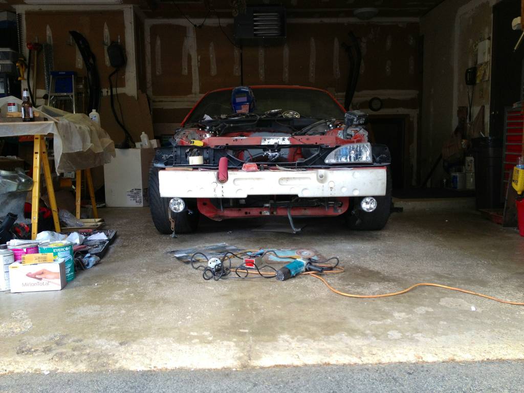

whiplash473
May 12, 2012
12,640
1,741
Northern IL
Dakota swap complete
Sent from bored/stroked iPhone
Here they are when they're done. I don't have a pic off hand with the front cover on.
