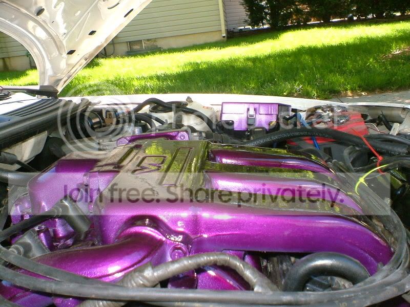

I would think that the intake would be subj to more temp changes, and higher temps then the brakes? If it doesn't hold up I guess I will end up re-doing them but I don't think it will be a big deal. I only drive it now in good weather now and take the truck on rainy days so it should hold up better then on a DD. It should be on its way tomorrow so I will post pics when it is done.
I am considering doing my CAI with it as well. IT was a cheapy and the polished finish has not held up all that well so I think I will do the same with it with the high temp metallic aluminum and then the green.
is that a purple intake on a white car? I could not find green in the stores, just red, blue and purple...

I cannot believe you posted that Adam.
