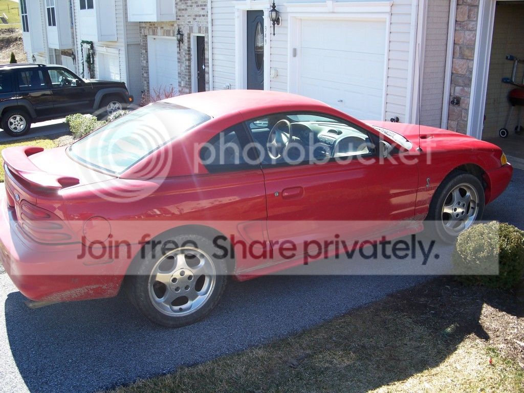

i am fairly mechanically inclined but most of my cars have been newer and I haven't had to tackle the entire car before. Pics below. Thank you for the thoughts!
before:
After:

It was neglected for about 5 years and sat unused for the last 2. Most of the deterioration was from just sitting outside in a yard.
