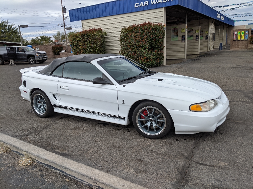

I am running H&R sports with poly isolators. I think it will be a tough comparison since I am running Tokico Adjustable drag struts for a fox body in front, J&M weight jacket LCA, J&M uppers, with no quads. Adjustable Tokico illumina shocks. Car is not a corner carver. Ride quality is good.
