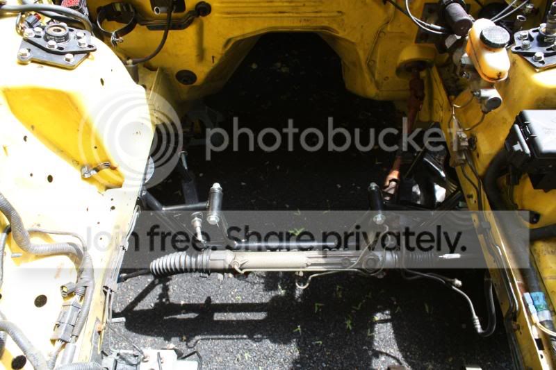

my rack is finally leaking in my 94 cobra and it has of course it has that 1 inch of play in it too like most i hear, A gentleman i work with has a 03 cobra rack collecting dust in his garage to sell me for cheap. is this a basic straight bolt on?. pressure lines and steering shaft will hook right up no problem?
would i benefit from a 03 cobra steering shaft over my 100k 94 cobra too or a MM steering shaft. keep in mind i dont road race just cruise for the most part.

I know the 03-04 fits 96-04, I'm not sure about 94-95. The racks are different because of the oil pan configuration, and I'd imagine they are valved differently as well (vacuum boost versus hydraulic boost).

The rack will bolt right up. Fox cars need longer control arms, because of the width difference, but all SN95 cars interchange. If you are not planning on tracking car, I would not waste money on the MM steering shaft. Also, don't forget to pick up Teflon seals when you reconnect the steering lines.
